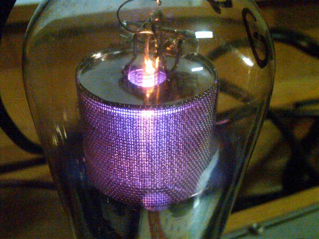

Once again, one of my favorite tube pictures -
This IS A BAD tube. If your glow is blue maybe not. Violet is bad.
If there is a blue glowing spot just inside the glass but not within the tube's elements, your tube is probably OK.
If there is a violet glow within the tube's elements as Phlogiston's photo shows above, your tube is bad, period, end of story.
Note: Not applicable to gas-filled rectifiers or thyratrons.
