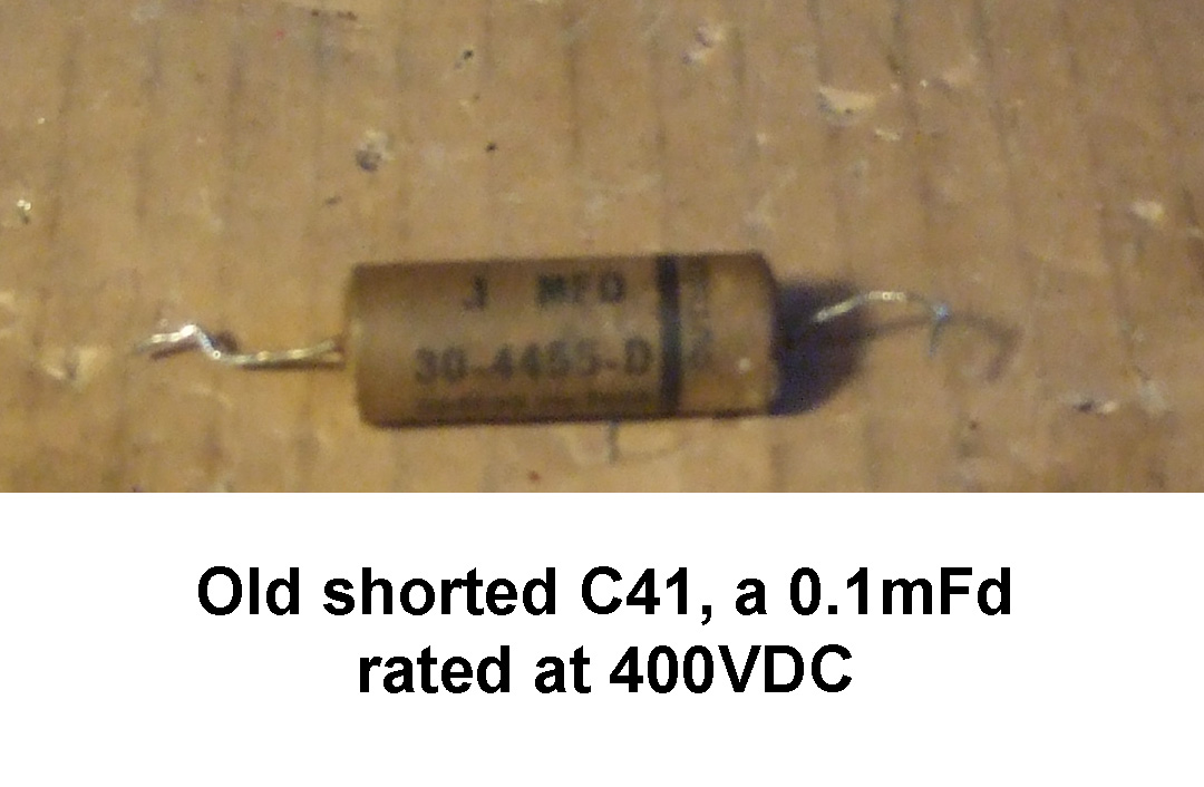

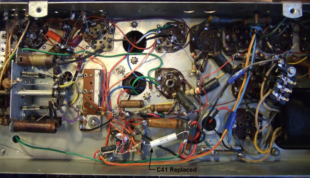

I was replacing various portions of B+ wiring on the 40-201 chassis and decided to take advantage of a lull in the work by checking resistance from various B+ points to ground to verify my work. I discovered that on the B+ line going to the IF and Mixer-Oscillator circuit had a short to ground. I had replaced R40 because it had increased in value more than 20% already. I disconnected the lead going to the two tubes and the short to ground was still there. I found that C40, a 0.1mFd @ 400VDC had shorted. I had ordered a 0.1mFd @ 600VDC to replace it if it was bad, so I had one on hand and replaced the offending part.
It is always a good idea to check for potential shorts before applying power to a chassis. After this capacitor was replaced there are no longer any shorts to ground on the B+ lines in the chassis. I will make one more check with the speaker assembly connected to make sure there are none in the field core.

No, I am not saying that I am not replacing all the paper capacitors. I am saying that I discovered this in the process of replacing them. This one would have been a deal breaker if I had applied power. Checking for shorts to ground in the B+ circuitry is always a good thing to do after or during repair and this was part of that process. The other thing I am finding as I continue replacing capacitors is that the resistors have changed in value anywhere from 19% to 57%! That was in the phase splitter circuit alone! There is no telling how many more are off value at this point. It appears that most all of the capacitors except for mica types will wind up being replaced. Many of the paper capacitors have already been replaced in the past, but I do not trust the replacements. This example goes to show just how bad these old paper capacitors can get.

All the old paper type capacitors have now been replaced and most of the resistors as well. There were a few exceptions. Some resistors were 20% types and bridged across an inductor. I left those alone as they are just there for reducing the Q of the circuit to broaden response. Some of the bypass capacitors in the front end and IF strip could be well served by .01 disc ceramic capacitors which would have shorter leads and less inductance added to the circuit. However, it is not critical since the IF is only 455kHz. In the RF it could be a potential issue as the SW high band operates up to 18mHz which could be an issue depending on other circumstances. All in all, I have to say the radio works quite well as it is. The last order of capacitors from tubesandmore also took care of replacing the new electrolytic that had shorted intermittently. The new one has a 450VDC rating while the one first used was only a 300VDC unit. It proved not to be able to handle warm-up voltage surges.
