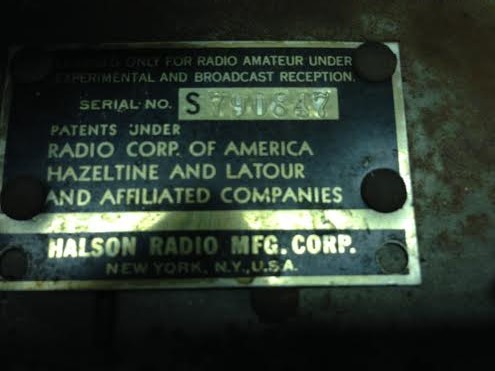

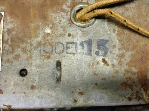

I am fairly new to radio collecting but I got this Halson radio that no one can identify. It clearly states model 15? but I cant find it anywhere online.
I attached pics so any help from the professionals would be great.
I'll look around on this. Is it possible to get a shot of the dial face and the riveted plate next to the model number? I'm wondering if it is a 'Plant A' radio. Thanks, Joe

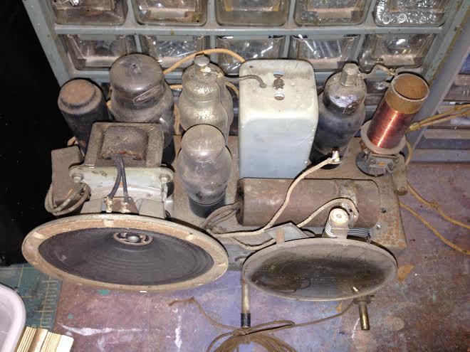

here are some pics.
Here's what I've been able to find. I can find no reference to a Halson model 15, or a Halson 4-tube radio with a 6A7 tube in the mix. They did make at least four 4-tube radios with a 6C6, 6D6, 25Z5, 43, and the L49B ballast tube. They would be the models 5LE, 5L-E, T5, and T10, none of which really look like yours. Federal Purchases also sold the Acratone 5E, 5F, and 5G with the same tube mix. Finally, Halson was known to produce radios for private labeling by department stores, etc.
Where does that leave you? It wouldn't be the last time that a radio has been purchased and one or more tubes in it aren't correct. Is there another name anywhere on the chassis or cabinet? If so, that may give an indication who Halson produced this for. Let me know. Joe

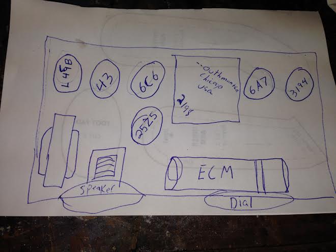

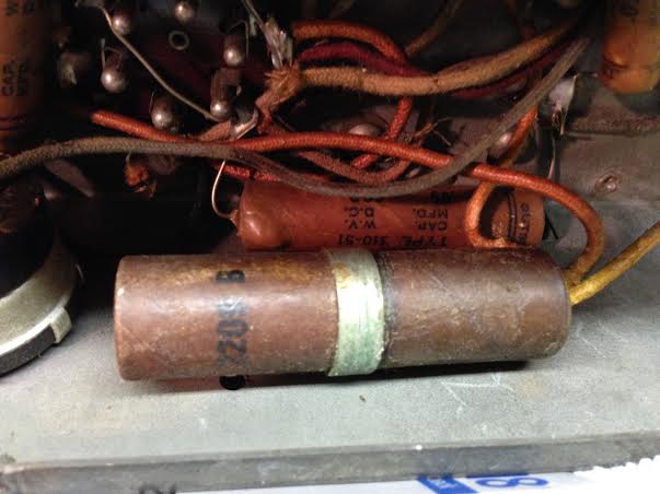

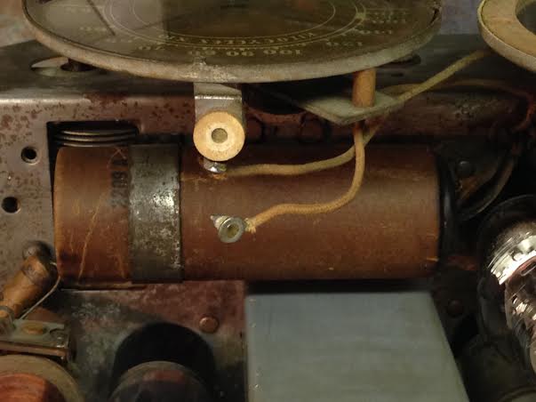

As for not needing the schematic I agree, I cant really read them anyway, lol. I have done all the testing and ordered all the caps except for the 2 big ones, most likely the electrolytics. only markings on both are 2209A and 2209B. I need to find out.
Look how many wires coming out of either electrolytic.
Typically these radios will have a filter with the first cap after 25Z5 being 20-40uF and the second will be after the field coil about 20uF.
There might be another one, possibly, this is why we need to know how many wires and where they come to. The working voltage for either one should be about 150V (can be more but not necessary and in fact can be less). Those are half-wave rectifiers so they will drop the Mains voltage.

they are both 3 lead caps. they say ECM on the tube ends.
it does not work so I don't plan on plugging it in until it is all recapped and the resistors are replaced that need to be.
