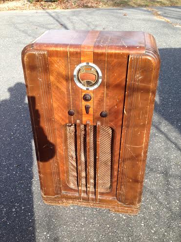

Here is my radio:

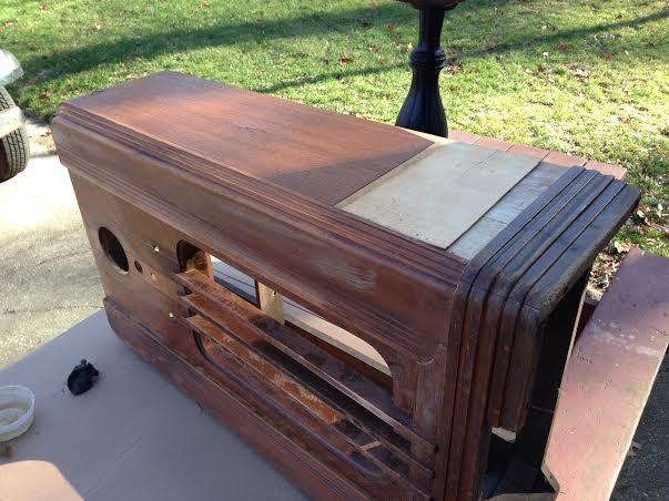

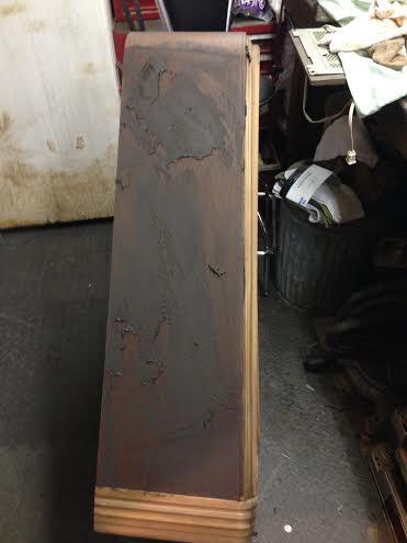

So I have been working on cutting away the old veneer and stripping the cabinet with #0000 steel wool and lacquer thinner.
Coming along slowly:

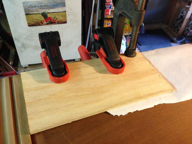

Ill skip the clamping since there was like 6 different gluing pics:
I am now up to matching the veneer:
That console looks like a challenge but definitely one that you seem to have the upper hand on. Your experience in furniture restoration will sure be valuable here. Keep the pictures coming! Nice job so far.

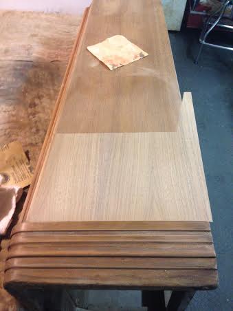

Well I have finished veneering the sides, curve, and top.
I sanded and spot stained to match the colors. I have gotten them close but the toner will fill in the rest of the color.

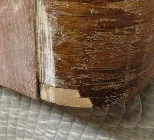

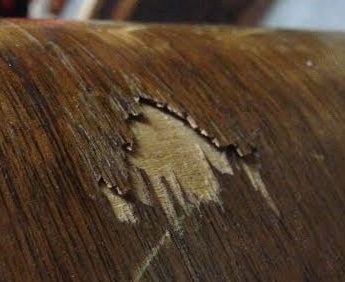

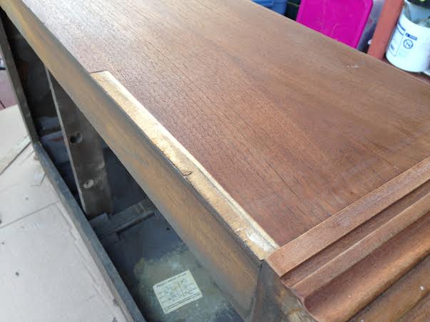

This one should have been more angled but after I lightened it a little it matched better:
But why use large rectangular patches with square edges ? No matter what you do to it finish wise that straight line joint with the old veneer will always show, since it's perpendicular to the grain. When you have that much veneer damage sometimes it's better to strip the remains of the old veneer off and start over.
Yeah I was going to but I wanted to keep it as original as possible. It was only 11 " high and the cabinet side is 46" high. I grain filled the cabinet yesterday morning early:

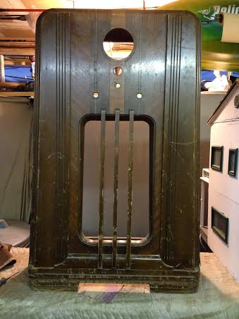

Here she is before I got started:

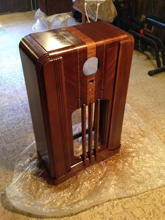

Ok She is done!
All I need to do is put the chassis back in!
