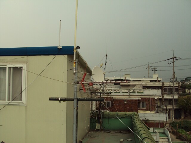

In most of Korea, it is indeed very VERY densely populated. There are over 54 million people here in a place roughly the size and shape of the state of Indiana. Even the town we live in is that way along the outskirts, but the town center is more of a densely packed small town, as contrasted with the high rise buildings outside of town. Most of the buildings are four floors or less, ours are 2 1/2 floors, with part of the basement floor being above ground.
Below is a shot I took from the roof of our building. The structure on the left is my former shop, now our SMATV headend. You can get an idea of the density of the neighborhood. As I said, we're fortunate to be in a small enclave with access to adjacent buildings, which gives us room to stretch our legs, as it were.

OK, thanks for the photo. Very interesting situation!
