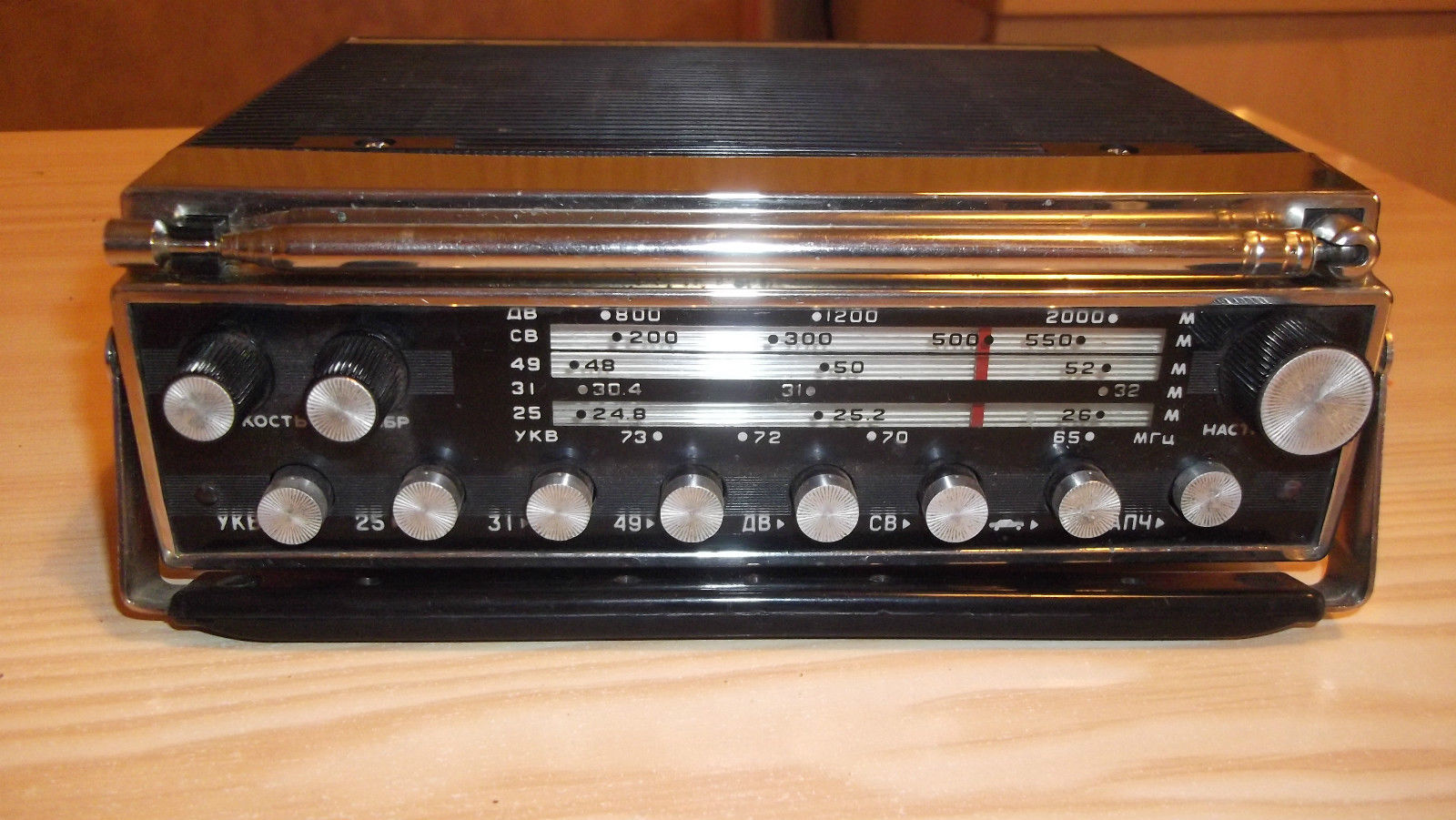

You pointed out one of these radios in another thread a while back. I went and found one to buy, and just got it in today. I'm a little disappointed that it's not a true convertible/portable. Can you tell me how to connect it to battery power so I can check it out?

It has no battery compartment, unless there was one that attached to the bottom of the radio. I'd sure like to see this one up and running. I love the style and it does seem to be quite well designed and built.

OK, so you have Ural-Auto-2. I think when autonomous it is fed from a special attached power block with 6 D batteries.
This is the picture. You can see the addition to the bottom.
http://www.rw6ase-dok1.narod.ru/f/ural_awto2_7.jpg
And this one is without it.
http://www.rw6ase-dok1.narod.ru/f/ural_awto2_1.jpg
Also, Ural Auto 2 is a michrochip radio, not all transistor really. So if a microchip is gone you are screwed. Not with the original Ural Auto.

There obviously were several cosmetic versions of UA2.

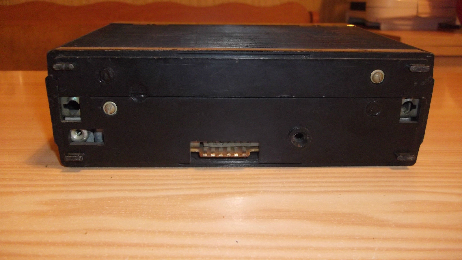

I see so many variations on the theme of these radios. For instance, on mine, there is (possibly) a power jack on the side like on the one above.. but it's a 2.5mm phone plug. Above that on mine is a record output. I think the top one is still a ground. I may try to find a 2.5mm plug for one of my universal power supplies and try that. Mine doesn't have a voltage indicated on it.

Mainly I just need to find out how to put power to it, and what voltage, and perhaps whether I can locate a battery pack to go with it. Don't need to be able to read Russian to figure out the controls.

OK.. I got it to make radio noises.
On the Russian site, I found a schematic and a pic where they had shunted around to connect the speaker. Between these, I was able to connect power and the speaker (though I was still driven to distraction, because the ground return on the speaker was also open, which I had to fix.)
Seems quite good on all bands, even that oddball Russian OIRT FM band (had to use my signal generator to manage that one, but it sounds pretty good.) I even heard WWVH on 10MHz (30M), though I shouldn't have been able to since the radio supposedly only tunes down to ~10.3MHz... I heard it on 30.4M on the dial). WWVH, on either 5 or 10MHz, is the only US based station (Honolulu, HI) that I've ever been able to receive from my location.

I take it you went to the same site rw6ase.narod.ru where I found the first two links I posted here.
The folks from the Russian site also pointed me to this same site.
Just in case from the replies:
pin 1-"+"
pins 5,6- "-"
I guess you are doing just fine.
One of the answers:
Brenda,
the 373 elements that were in use in the Soviet union and were the size of today's D elements had very low (0.7Ah) capacity.
This could be substituted by today's 9V alcaline battery which is 0.56Ah.
If you use a Lithium 9V battery it is 1.2Ah.
It is a small battery and could fit inside the radio
