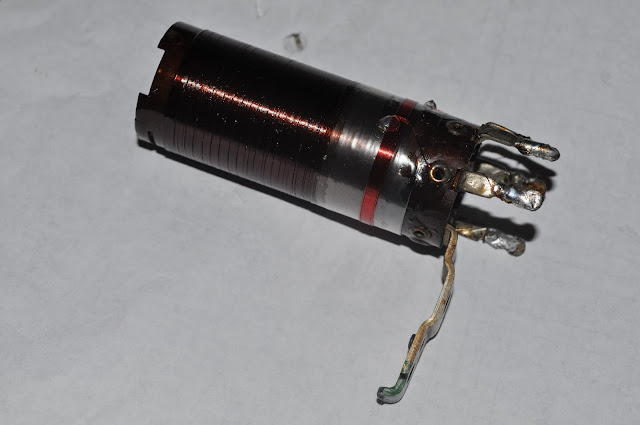

Here's pics. The before is the oscillator coil, the after is RF ready to go back in. They look essentially the same.
[Image: https://lh6.googleusercontent.com/-Jm12L...C_7975.JPG]
[Image: https://lh5.googleusercontent.com/-OXK_6...C_7982.JPG]
At the moment, my oscillator circuit requires a jumper lead connected to the top of the primary in order to oscillate. Not connected to anything, I don't have any idea what it's doing electrically. A user here said to replace the tube. You might want to get a spare 36 or two.

Nice looking rewind job. BTW, the lead attached to the primary might be what they used to call a "gimmick." It's a piece of insulated wire, usually not connected to anything at one end but sometimes routed near another conductor, just to add a tiny amount of capacitance to a circuit.
They're often found on coils & transformers of various types as a short piece of magnet wire routed across the coil at 90 degrees to the rest of the windings, connected at one end only.
Gimmicks are sometimes seen on tuning capacitors as a piece of regular insulated hook-up wire, sometimes running from the oscillator section to the antenna section, but only connected at one end or the other.
Occasionally, you see a few turns of wire wrapped around a cylindrical paper capacitor.
A gimmick is sometimes represented in the schematic as a stray line with a curlicue in it, connected at one end of a coil, which tells you only that it is there, not how it is supposed to be run. Sometimes gimmicks are not seen in the schematic at all, but they need to be there all the same.

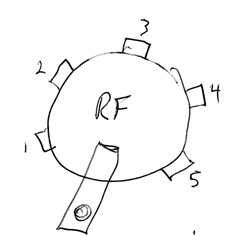

I can't thank you enough for your help. Just so we're on the same page, looking at the bottom of the coils, with the mounting bracket facing you, the lugs go clockwise starting at the bottom left, like this crude sketch I made of the RF?
That said, I get continuity between lugs 1 & 4, and lugs 2 & 5. Can you identify which 2 lugs are the primary connections and which two are the secondary based on that sketch?

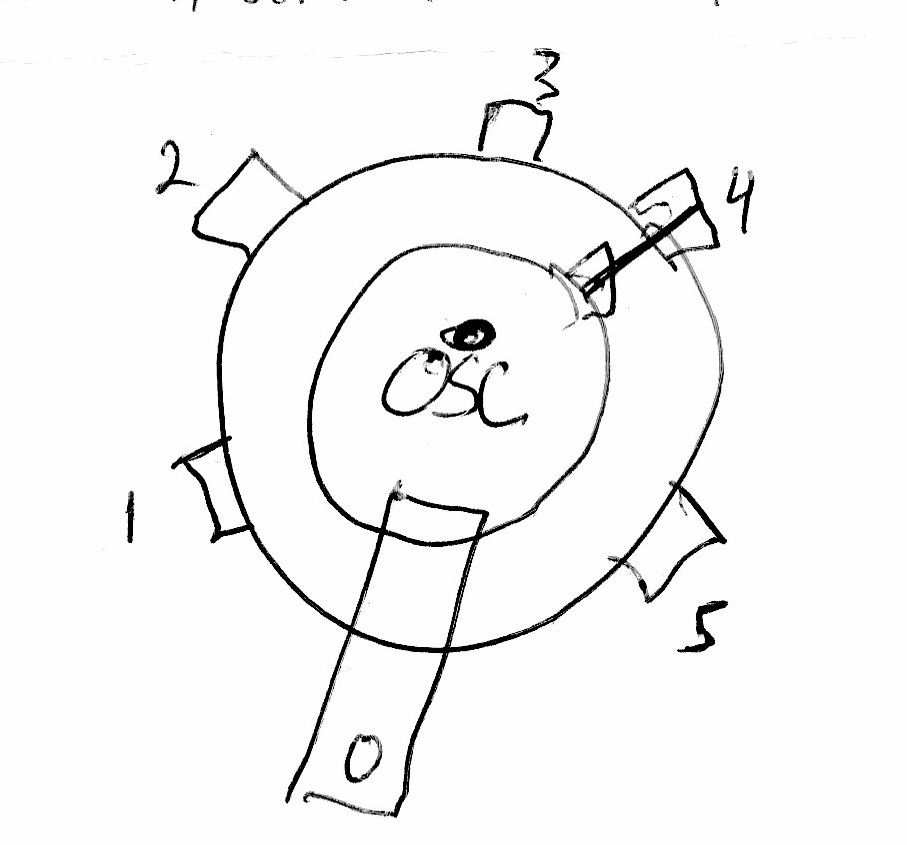

Here's a similar sketch of the OSC coil.
Lug number 4 has the inner coil attached (soldered) to it. Is the numbering correct on this coil based on what you found, again looking at it from the bottom with the mounting bracket facing you? On this coil, I get continuity between lugs 3 & 5, and the center wire (dot on sketch) & lug 4. Based on this, can you identify which lugs the primary and secondary are connected to? And, also which lugs the tickler are connected to?
Knowing this would be EXTREMELY helpful to a coil winding novice like me. Thank you SO much!! And my apologies for my crude and sloppy sketches, but it was easier for me (and faster) than taking pictures and editing them, adding numbers to them, etc.

Alright, looks good.
For the RF, you shouldn't get continuity from 1 to 4 based on my coil.. I have the primary, which is the small coil that goes bad, marked 1.68 ohms on the schematic, between pins 1 and 3. Again, that's 13 turns clockwise, with the bottom of the coil (nearest the lugs) connected to 3, top to 1.
The secondary is something like 100 turns, connected between lug 5 and 2, with lug 4 going to a center tap to select the police band. I don't have more specific notes on it.
I would clean off the old coil (make your own notes, just to be sure. Drag a needle across the windings to count them). Once you do that check the measurements again, it's possible they are shorted, but not likely. Our two radios could also have different parts, I suppose. You aren't talking about the antenna coil, are you? That one also goes bad, from lightning.
For the oscillator coil, the culprit is the tickler winding, on the bottom of the outside coil. Over a piece of decaying celluloid. It is between lugs 1 and 2 on your diagram, 1 at the top, 2 at the bottom. 27 turns. FYI, it is erroneously marked 5.25 ohms on the schematic. Expect about 1 ohm from your new coil.
The primary is the small form inner coil, connected at the top to the loose wire, and the bottom to lug 4.
The secondary is the outer coil under the tickler, lug 5 is the top, 3 is the bottom. All are also wound clockwise looking at the bottom.
