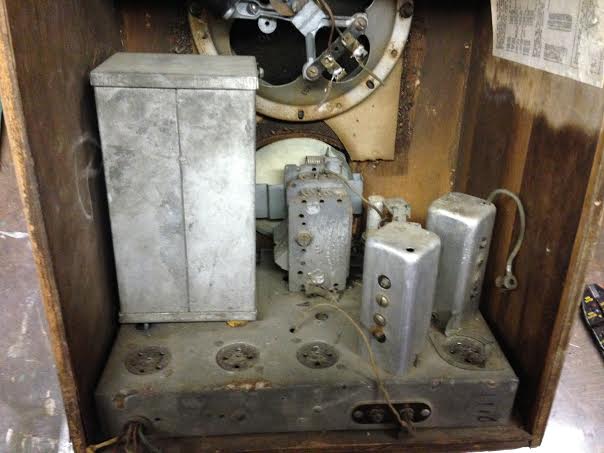

I have my first battery set and have some questions.
Can I make a battery for this radio?
I dont want to have to buy all the tubes if I cant make it work.
I remember hearing it is quite hard.
Maybe someone I can hire to do it?
It is an Aircastle but I have no model # yet.
Any thoughts?

It won't be a problem at all, but as others have mentioned it will require a few batteries or an eliminator (power supply). I suspect that radio may run off a 1.5V "A" battery and a 90V "B" battery. Some battery sets from this era ran off a 6V battery.
These radios, often called "farm sets", aren't as popular with collectors or the public because they aren't able to plug them directly into the wall. Being not as collectable also means they usually sell much cheaper than a similar 110V radio.
With the minor investment of a power supply (battery eliminator) these radios can be a lot of fun to restore and play. Decide what you want to do, find a model #, and then we can advise you better on what you'll need.
Just a little off topic, but I still remember listening to my first battery powered restoration. It was a mid-20's home-brew three dialer with a cheap little horn speaker, but I have yet to match the thrill of hearing a station come alive through that primitive old set.

I have been told it is this schematic by another member.
http://www.nostalgiaair.org/PagesByModel...003114.pdf
It has the right tubes but I haven't found any match on the cabinet

If that is the radio, and it has a vibrator as shown, then it is probably a 6V set.
Also looks like the speaker wiring is missing so you may want to inventory the rest of the chassis to see if anything else has been removed/tampered with before you invest too much time or $$$ into the radio.
Posts: 5,650
This set used 2 volt battery tubes in a series parallel arrangement to add up to 6 volts so they could be run from a car battery of the era. It's a farm set from the mid to late 30s or so, yes it can be fixed up to work but it's not as straightforward as a normal battery set with "A" and "B" batteries. Aside from the tubes all of the other important parts look like they are still there.

I am currently working on the chassis and boy oh boy are there a lot of caps! there is a rectangular cardboard box in the middle that I have no idea what it is.
I dont think this is going to be a repair I can do because of all the loose wires. Maybe I can try to follow the schematic and rewire it.. It will at least help me learn to read the sch. better, (well read them at all)

I have worked on a few 6 volt battery sets and if I remember correctly there is a cap near the vibrator
that is about 1000 to 1600 volts. I don't see a parts list so I don't know if yours has a cap with that high voltage.
When you replace that cap I suggest you check the voltage on it

Yes there is a cap and it is .5 10? I am guessing that the 10 is 1000V?
There are 3 of these.
There are a lot of caps crammed into this little set,
