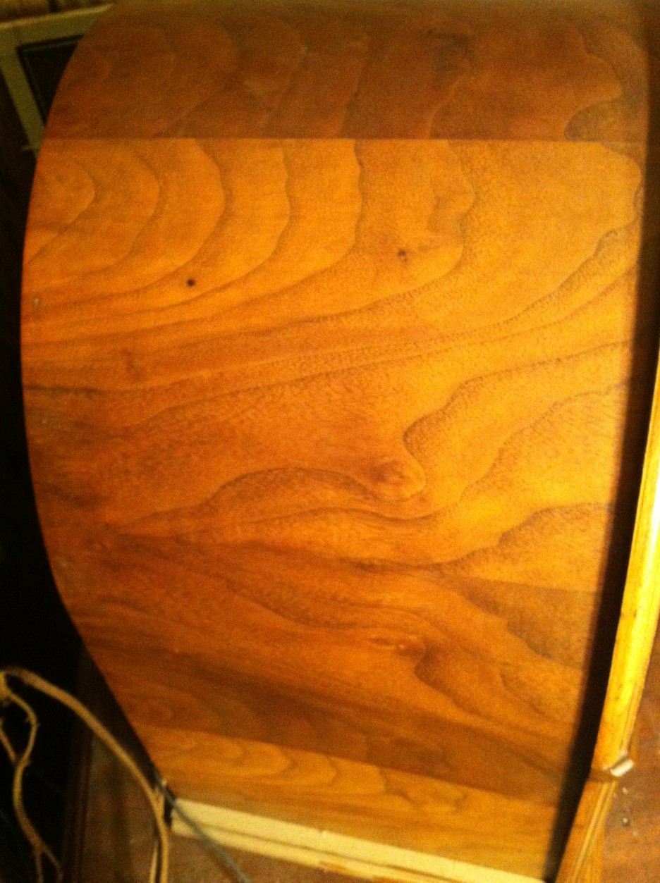

what type of walnut is this?
I am in the process of re-veneering another 70b and I have bought figured, burl, and quarter sawn but I can not find this grain pattern. does anyone know what type of walnut this is?
Crown cut I believe
This looks closer than anything else I have bought so it will have to do.

Rotary-cut, good enough for the side of a cabinet. It will be toned very dark anyway, so you won't see the grain.
That isn't rotary-cut, it is flat cut. Anyway, it would look really nice on the sides of your 70.

So is the ebay veneer the right cut? The picture in the first post is my restored 70 with original veneer, I want the veneer to be the same on the one I am starting on.
The first post picture looks lighter than it really is, it is actually a syrup color.
Yes, the original veneer on your cabinet is flat cut, sometimes referred to as plain cut, as is the veneer you bought on Ebay. A quarter-cut veneer would have a close, straight grain without flame grain and figure.

Hey guys, that is a light color Claro walnut, which is what the cabinet makers used on the radios in the 30s,.. The Stratosphere sides were done with Claro, and a lot of Midwest cabinets displayed it , as well.
The lighter the color, the harder the true Claro is to find.
I am referring to the first photo of the veneer on the cabinet.
I am too sure about the Ebay stuff. It has white specs on it, which is not natural to the species.

You're right, it can't be rotary with the book matching.
