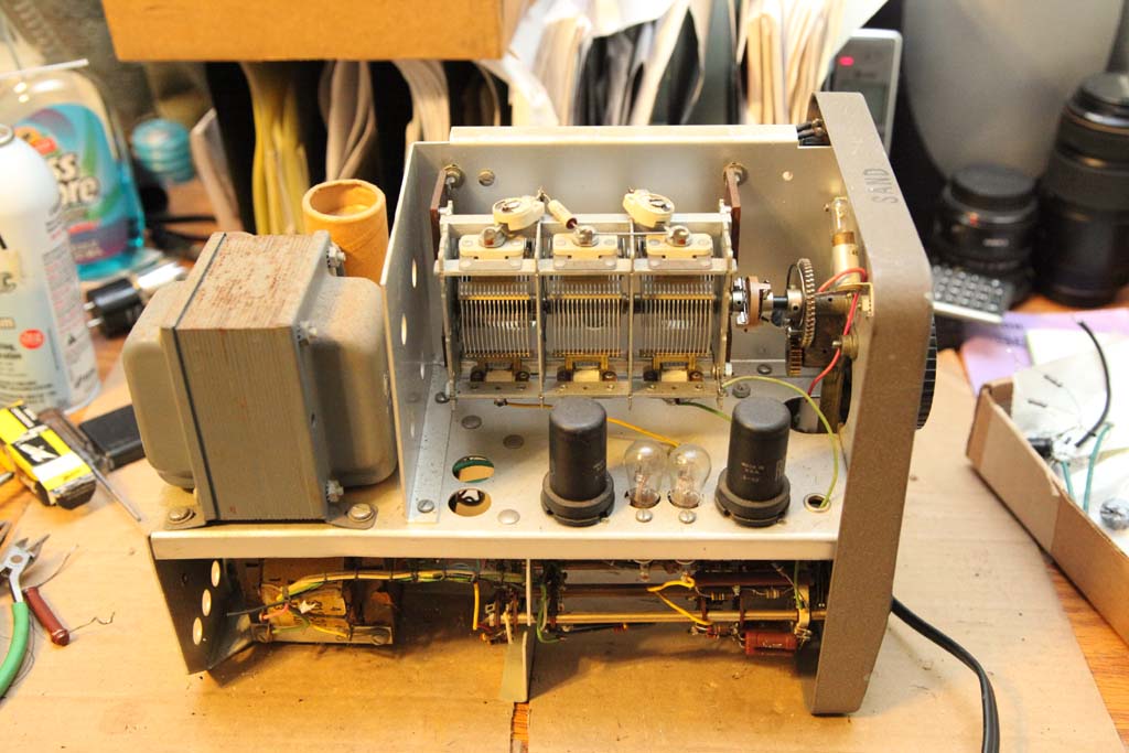

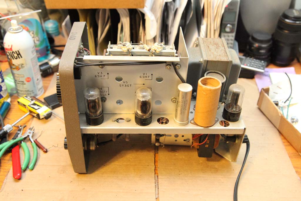

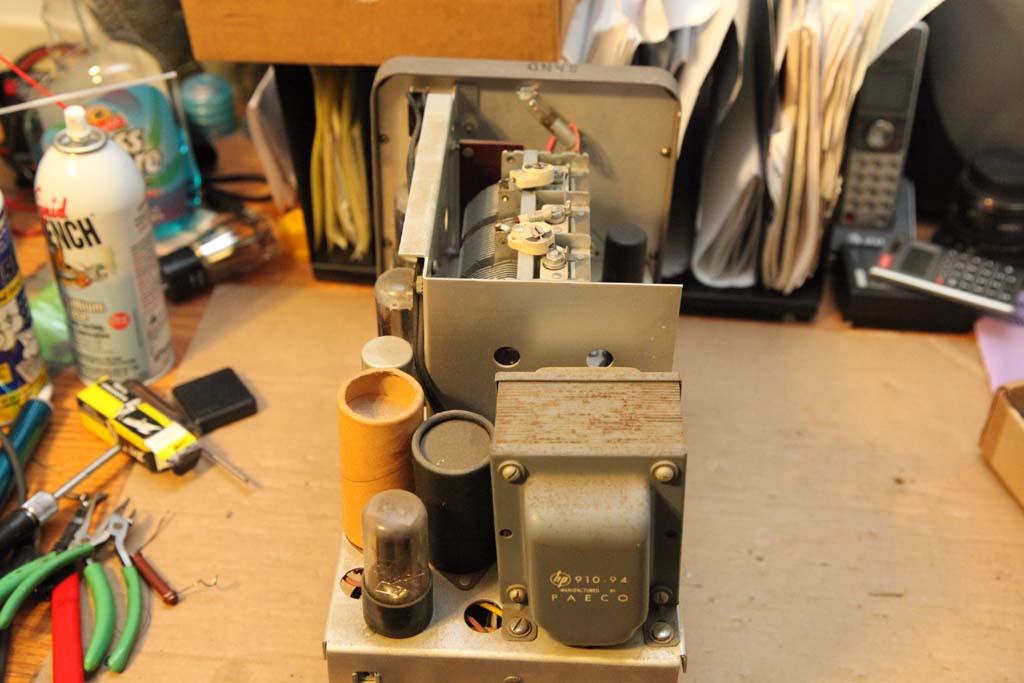

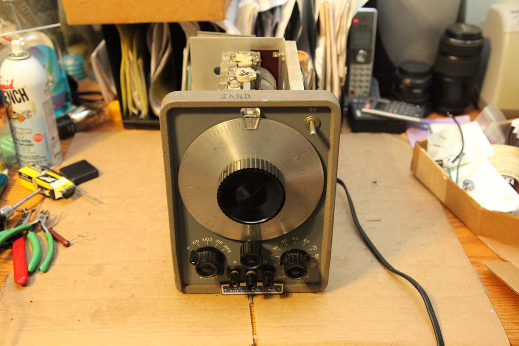

Well, I took the screws out and it did slide out of the case.
I took some photos just to have some reference in case something gets screwed up and forgotten.
Also it is a good way to notice right away what could go on missed or noticed much later.

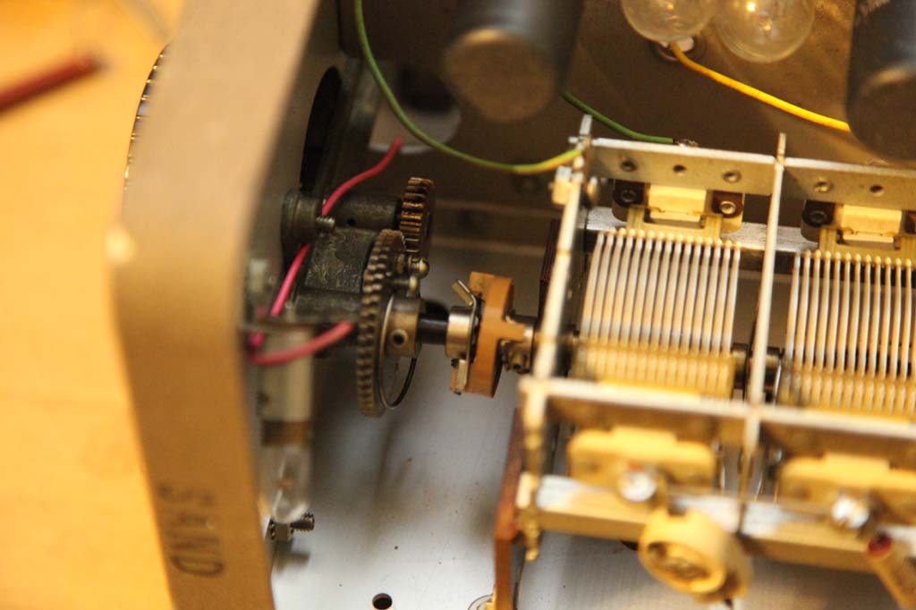

Like in this case a bent variable cap coupler.
I will put the photos up here tomorrow, now's late.
Will need the sch but this I think does exist in several places.
The very first resistor mounted on a switch I tested was right on the money so it gives me hope I might only need to deal with electrolytic caps. Provided the power is good. The eBay photo shows front panel light on which again gives me some hope the power might be OK.

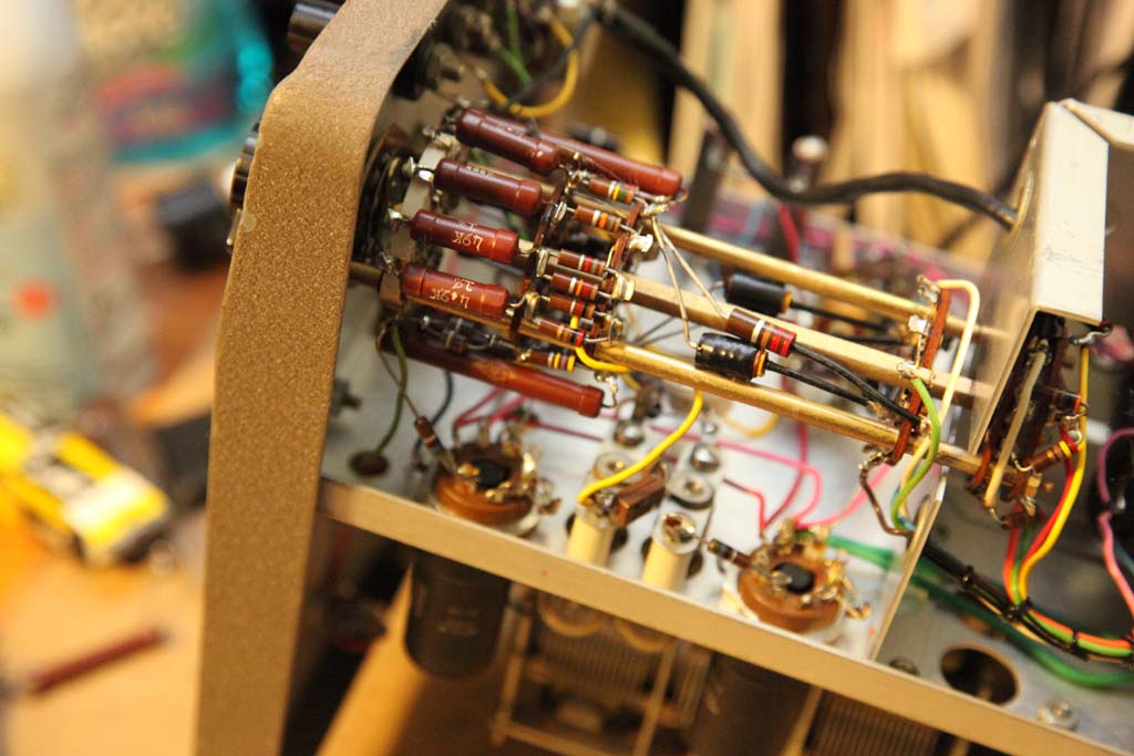

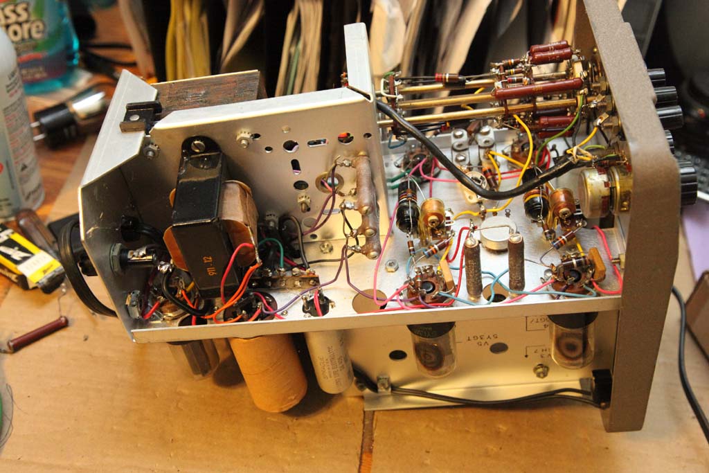

More of the same....
This last one shows the bent coupler. Hopefully will survive bending it back.
Reforming 1st cap....10uF 450V...they called them "long life" for a reason I guess, this one is 40uF measured 44uF.
Of course it is leaky and is getting better.
I only had a 130V Variac and a rectifier bridge and it is not enough, though I got 200-some volts out of it and brought it down to 13uA leak.
Reforming needs to be done close or at rated WV.
Then I realized I only need two diodes and two caps to make a doubler so I quickly (2 minutes) twisted together two caps and two 1N4007 and got me a doubler....right now working at 300V and can go to 380V which is closer to 450V than what was before.
Almost 400V of bare wires in front of me on the table.....nice!

If the coupler fails they are a fairly common item and shouldn't be hard to find.

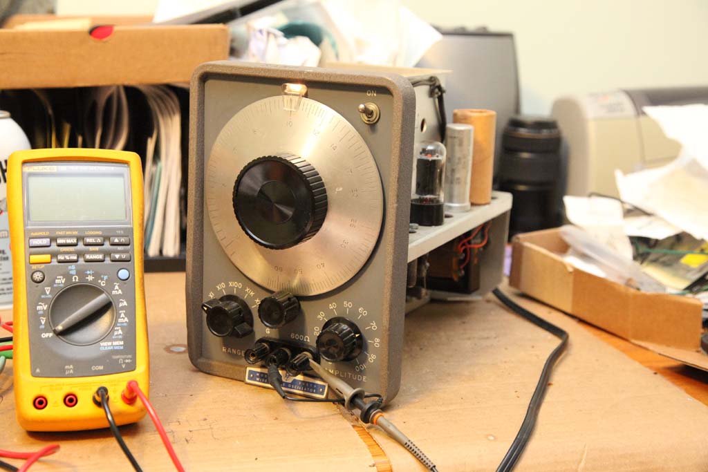

Well, Yesterday the cap came, I soldered it in.

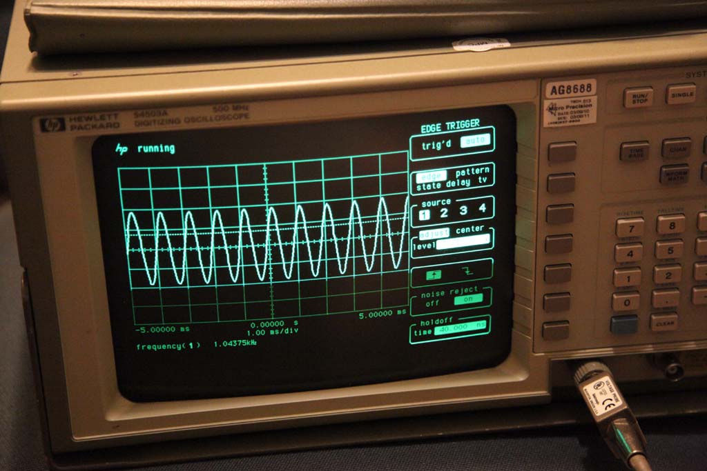

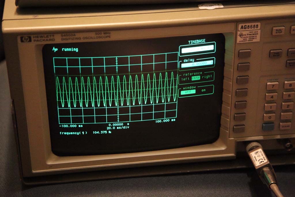

Today checked all tubes, then checked the AC voltages, then DC voltages.

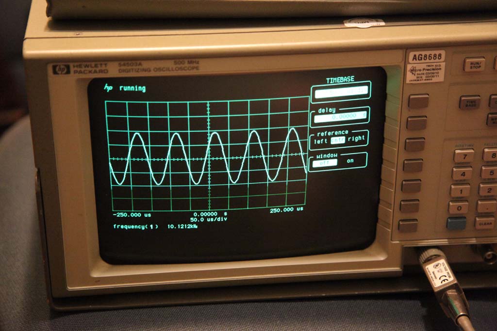

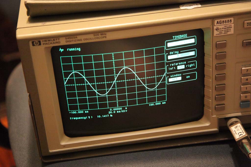

Then put the scope to the output.
The stability of this thing is very good, as promised in Master Degree thesis of Bill Hewlett's.
Here are some photos:
Notice the stability of the amplitude over the frequency range:
(Freq. reading could be seen on the scope at the bottom)
Front view
10 Hz
100 Hz

10kHz
