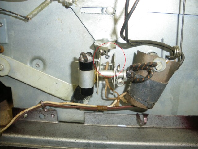

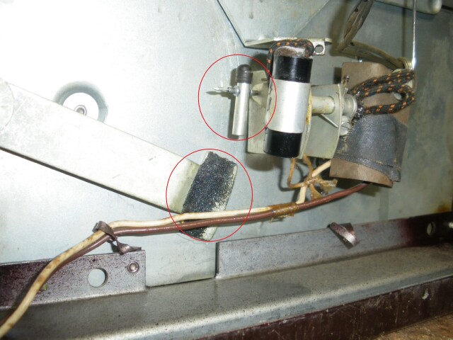

As I have absolutely no experience with these turntables, I need to ask what I need to do to complete this one.
In the first pic it appears that there was originally some sort of block attached to the tone arm lever so that it can activate the pinion to operate the mercury switch. It also appears that there may be some other parts missing from that assembly, as the pinion doesn't do anything to the mercury switch anyway. The mercury switch itself, sans activator, works properly (motor turns on and off).
In this second pic, there appears to be some spring or linkage missing.
I hope someone can help clear this up for me.
Oh, I also need to find someone to reflock the turntable.
