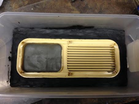

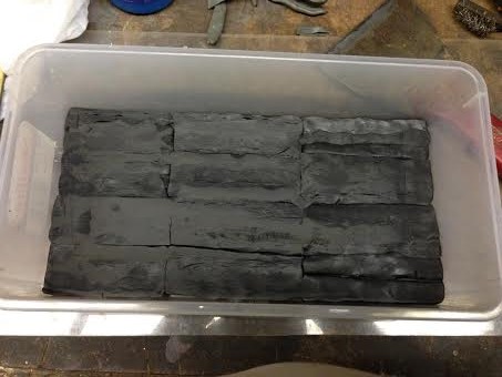

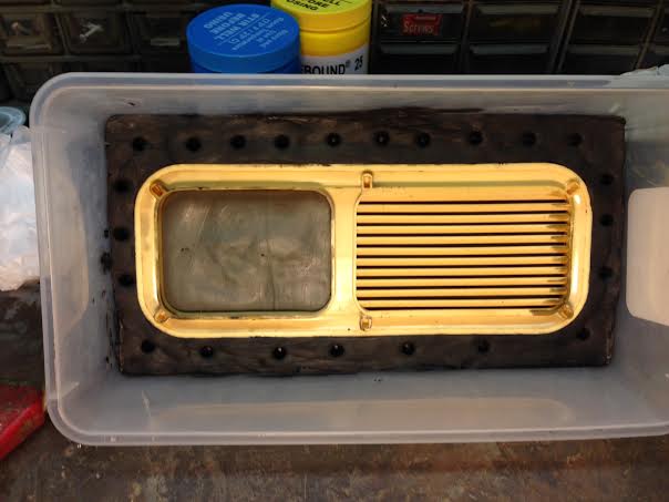

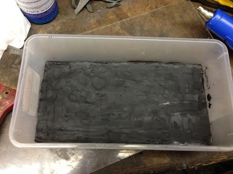

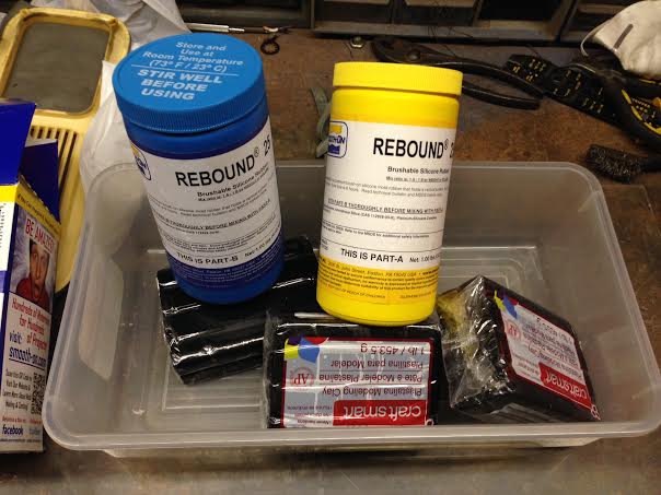

So I have finally gotten the time to work on making this new grill mold and I now know why no one has done it. It is a complicated mold but I have been piecing it together to see where there would be issues and finding ways to work around them.
I have received my load of mold supplies from smoothon.com and have begun forming the clay layer for the bottim half of the mold.

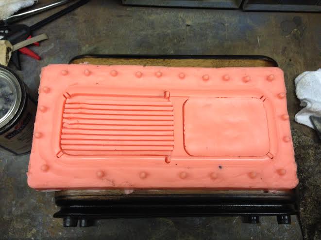

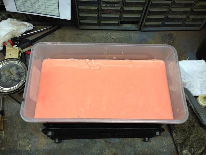

I purchased smooth-on rebound 25 But after pouring it I think it might be too soft. I am going to demold the piece later today and see how the extra thickness I added has done for the dexterity of the bottom half of the mold.
Unfortunately, I only bought the $30 size and had to use it up. Now I will have to buy the $200 size but I will wait to see how strong the mold is.
Hey all,
Ok I have demolded the bottom half and I was correct in my thinking. Although it is a good copy of the grill, it is too soft to keep a perfect form so I will be reordering Smooth-on OMOO 25 or 30 in the larger size to make the mold.
You have to buy non-vacuum press 1 to 1 mix ratio!!
Good thing is that with the tiny alterations I made to the grill, there are no issues in the de-molding process as long as I use a mold release. You really don't need one with silicone as it is a very non-porous almost moist surface but it cant hurt.
