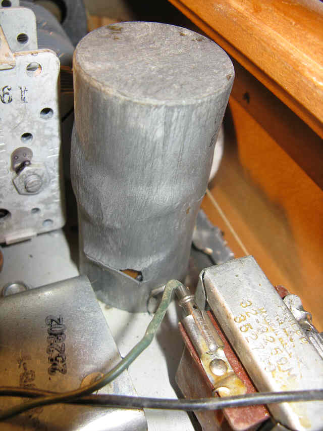

I have to get a closer look at it.
I just got a better look at it.
I see why this happened. In the past someone did a repair, replacing the main filter with individual caps.
It's actually amazing they found caps small enough to work in the space that is available, at the time.
But they left the original cap connected!
Not a good idea.... it appears to have heated up and warped the cast cover, it also starting to fall apart
I may post photos later.
This one is like what was described, with individual wires coming out of it.
It's a bit of a mess on the bottom side.
The case of that cap is a casting.

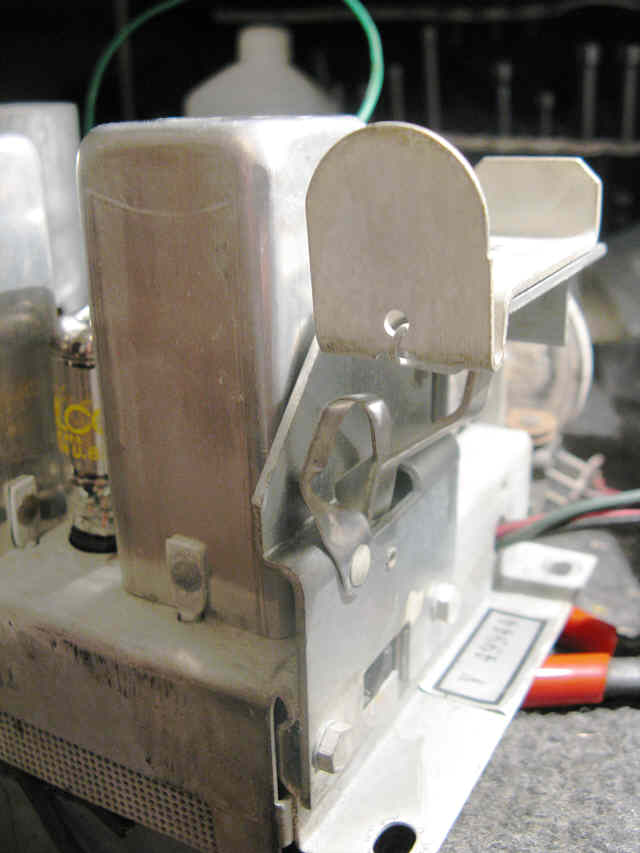

I have a question about ac/dc operation.
It has a metal u shaped bracket on one side connected to a switch, I assume the switch to change it over.
But it's spring loaded and returns to a fixed position...not sure which AC or DC is the at rest position at this stage.
Someone please explain to me how they used this?
If it is like the 46-350, there is a rod coming out of the back of the chassis on the right side as you view it from the rear. A spring holds it in the "out" position, which automatically moves the switch for AC operation. Push the rod in, and it is set for DC operation.
There is a spring-loaded bracket attached to the side of the lid on the back of the cabinet. If you shut the lid with the AC line cord folded up inside the radio, that spring-loaded bracket pushes the rod in, connects the battery to the radio and disconnects both the AC line and the rectifier.
To operate on AC, you open the lid, which causes the rod to spring to the AC position. Then you swivel that bracket up by hand, and as it moves, a tab uncovers a slot on the side of the lid, just below that bracket. You run the AC line cord through that slot, and the cord itself holds the bracket up when you close the lid, so that the bracket misses the rod, leaving it in the AC position.
Back open -- automatically set to AC.
Back closed with cord entirely inside the radio -- automatically set for battery operation.
Back closed with cord in the slot -- automatically set to AC.

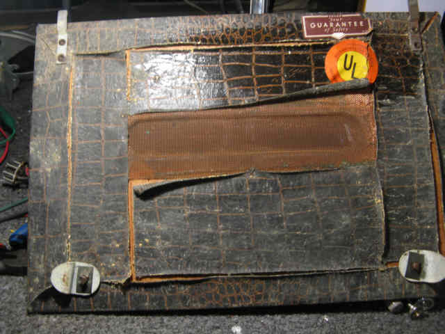

Here is the cap, the switch setup and back
Could it be something to do with the cord itself?

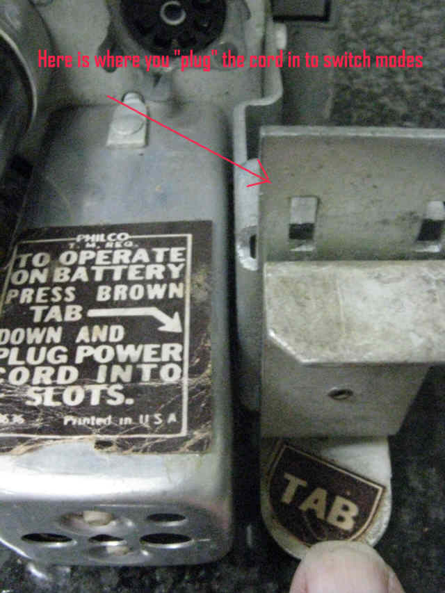

I figured out the battery switching.
As you see in the first photos, it's tough to figure this out, looking at it from the back of the radio
Once the chassis was out and the 1U5 and shield were removed a label on Z301 if can was visible.
The idea is simple, normally the radio defaults to AC operation.
But if you take the ac cord plug, and press that bracket down it reveals 2 slits that match the plug.
You plug the end of the cord in to keep it in Battery op.
See photo
