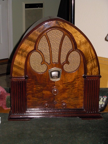

Here is an original pic:
Ron will know though.
