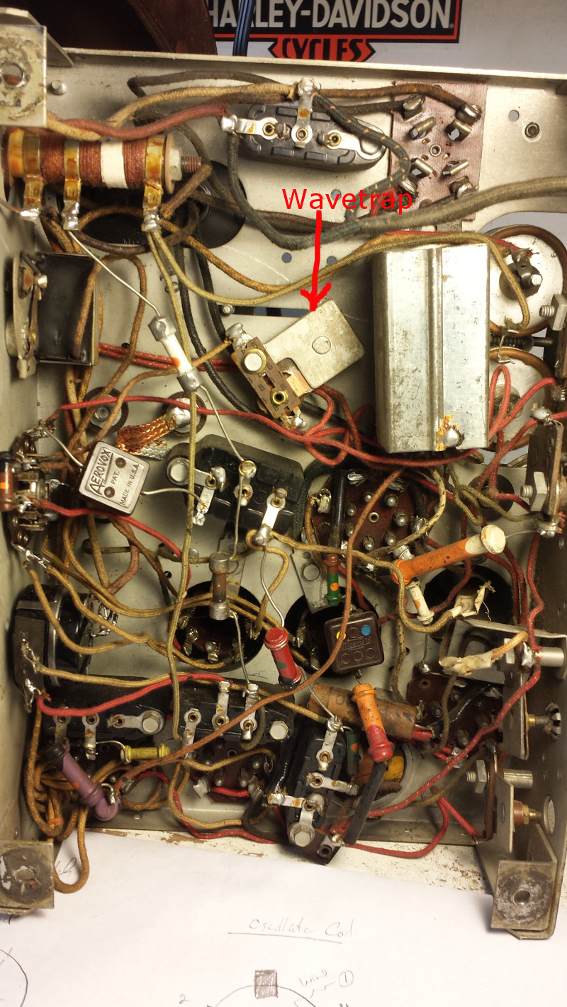

Attached is a pic of my Philco 60 chassis prior to restoration with the wavetrap marked. The flat metal part is the capacitor, and there is an inductor buried back behind the cap. There is an adjustment screw for the cap accessible from the top side of the chassis.
The purpose of the wavetrap is to block IF frequencies (460 kHz here) from entering the antenna circuit. Anything at those frequencies coming in from the antenna is noise, and it blocks this from the RF and IF amplifiers. The later models of the 60 had this, and you can see the updated schematic at http://www.philcoradio.com/tech/60evol.htm

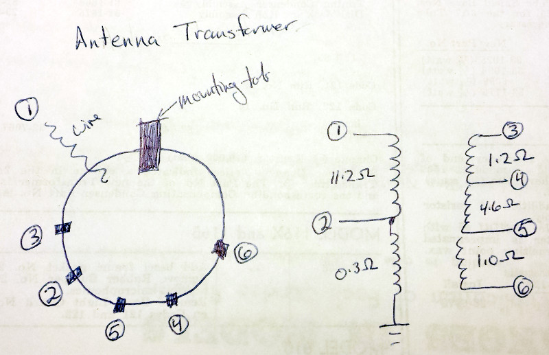

Sounds like you are making progress. I get the sense that your problem may be in the antenna transformer, so here are the notes I made when I worked through that section. The values noted are my measured values.
The antenna input into the primary is a wire coming down from above which does not have a solder tab. In my set, the 0.3 ohm section was open and I had to rewind it. I used 7 turns of magnet wire, being careful to wind in the same direction as the original. I found a very helpful post on this forum about that particular repair.
I would suggest trying to feed some audio riding on a 460 kHz carrier into each point in my diagram. Make a chart of where it works and doesn't work, and you can decide if your antenna transformer is working or not. If you use IF instead of some other RF frequency, you should be able to hear something regardless of the tuning capacitor setting. (In theory all of the 460 kHz should be rejected by the tuning circuit, but in practice some will make it through to the IF circuit and get amplified. This is why they have a wavetrap.)

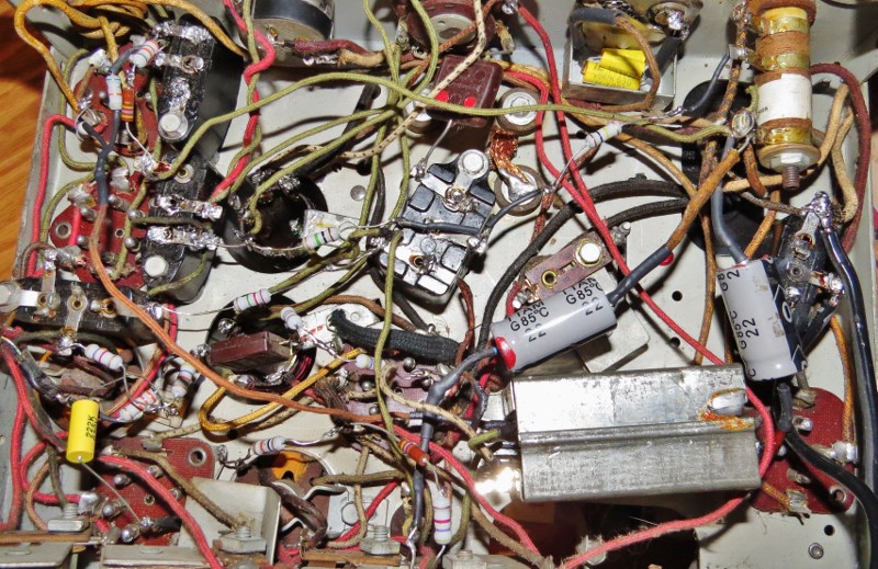

It's hard to really trace much from your picture given the resolution limits. Simple things to think about would be to check your solder joints (a cold joint can be surprisingly tricky to figure out!) and making sure all connections have good mechanical support.
If you would find it helpful, shoot me an email address and I will send you a full resolution picture of my chassis before after restoration.
