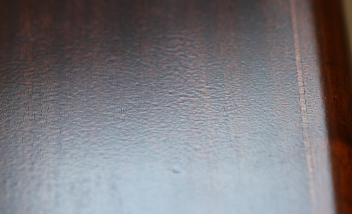

No point in guessing. Show us a picture.
Have you tried thinning the laquer more so it can atomize easier? I was having a problem like that and it seemed to make a difference by thinning the laquer more. Maybe adjust the rate of flow for the laquer also. Sounds like an adjustment on the sprayer may help. Like they said previously you can sand it smooth and keep sanding with higher and higher grit sandpaper til it is as smooth as you like it to be.
As requested, here is an image. Before this light coat of lacquer from a rattle can, I sanded the previous coat to the proverbial "smoother than a baby's bottom." As this coat was going on, I could immediately see the texture returning. This is very frustrating... Earlier in the week, I was working on restoring the metal frame of a Sonochorde speaker. I ended up sanding the rust from the frame and coating it with this same can of semi-gloss lacquer. I had no problems with the surface texture. I don't get it - what is going on here? The whole surface looks like this.

That's a very good photo, but it's still hard to say what it is without seeing it in real life. I would say that is orange peel on your cabinet. A couple of those larger circles might be very, very minor fisheyes. It could be the lacquer, or it could be from some surface contamination. If it were mine, I'd consider two options - Spray another very heavy coat and let it flow out and see how it dries, or I'd sand it smooth, coat it with some spray sanding sealer and then try to clear it again. Maybe someone else has a better idea? ..I know Steve Davis is an outstanding refinisher, so hopefully he will offer some advice.
Look like it is contaminated with something. A heavier coat is going to fisheye worse up to the point it is so heavy that you get runs. If you were using spray equipment you would add fisheye reducer. In your situation, I would wait a day or two and recoat and then again, building up enough material that the roughness can be sanded out prior to polishing. If you are using semi-gloss, which is what that looks like, polishing will need to wait for a month or so after the last coat.

I agree with Pushpow that is a good picture and it looks more like orange peal. Since you can't easily thin a rattle can try shooting in a cooler place to allow more flow out time.

Tab: Interesting note about steel wool. I used a new sheet of 400 grit paper for this one. I wiped the debris from the surface with a cloth that *could* have had some contamination on it...
