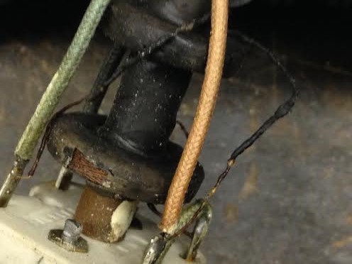

this is what they look like:
That IF transformer looks pretty smoked. Do the coils still measure good as to continuity and proper resistance?

OR, put your meter on the ohms scale and set it for the lowest resistance range. Place the leads across the tabs sticking up in your picture, one on each side of one of the trimmer cap. You should have a low resistance reading. Now go to the other trimmer cap and repeat, hopefully with the same results of a low reading. A high reading (probably in the megaohm range will indicate an open coil. Make sense?

In the picture some of the tiny black wires look like they have crumbling insulation on them. If there is any chance of them touching anything, unsolder one end of them and put a sleeve on them, very carefully. That'll make them better than new. The primary side wires have high voltage on them. They'll make sparks if they touch the can, and that will likely burn out some tiny wires you can't replace.
I've never done it myself, but I've heard of people painting little wires like that with some stuff made for the purpose instead of sleeving. I can't remember the name of it.
