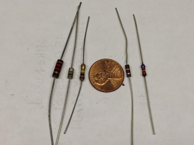

Are they old ones or new ones? Something like this could help: http://firetrucksandequipment.tpub.com/T..._217_1.jpg
But it's hard to tell. Each wattage has consistently become physically smaller over the years. Do you have a photo?

As it was mentioned a photo would help because it depends on composition and/or age. When you take the picture include something known to compare size to, like a penny.

http://www.mouser.com/ds/2/303/little_demon-180342.pdf
This is Ohmite datasheet showing similar resistors with sizes.
Might not be exact same but should give you an idea.
The 2 larger ones of the 3 on the left are 1/2w. The rest appear to Be 1/4w
There are new resistors like the one on the right looking like they are 1/4W that are in fact 1W resistors. Just recently used some.
They are of course not carbon type. First time I saw them I did not believe it.
