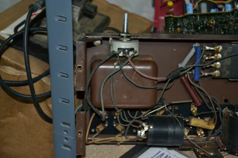

Could someone please let me know where the antenna hooks up to on a radiola 18 ar936? I finally received the ux280 tube and everything powers up but I don't even hear a chirp. I'm about ready to throw the towel in on this thing
There should be a marked antenna post somewhere on the thing. Also, look at the back of the cabinet, might be marked 'ANT' near a hole on the back to give you a clue.

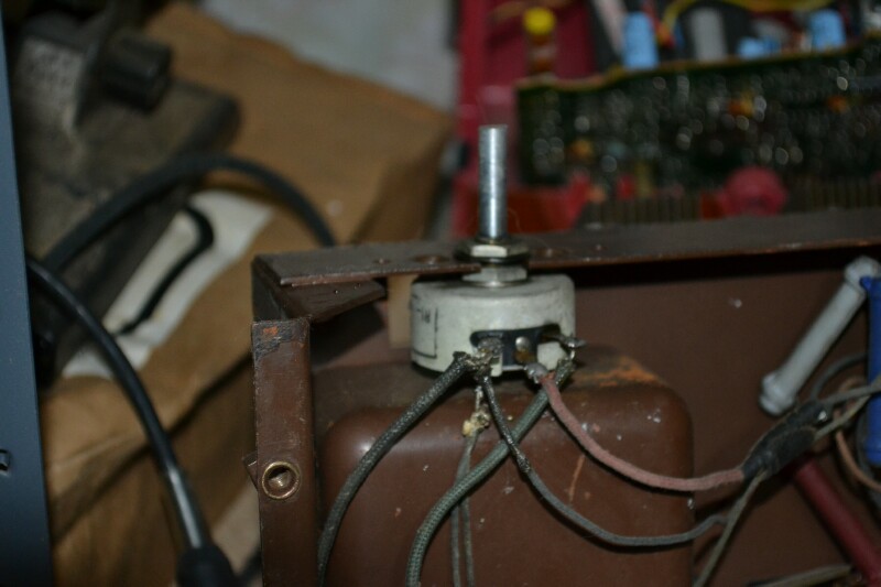

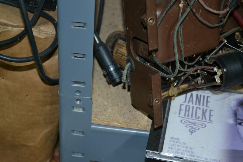

Radiola 18's don't have antenna posts. They have two wires coming out from the right hand side of the main chassis. These connect directly to the chassis ground and to the input of the 1st RF amp with a resistor across them. If I get a chance, I'll take a pic of one of my chassis' later today and post it for you.
I was remembering a different TRF chassis (a Steinite, I believe). It is much the same, however, with the 18 chassis. The antenna and ground wires come in on the far left side of the chassis, and run up to connect into the volume control. See pics below:
Thank you very much. Those definitely help. The schematic I found had the speaker wired up to there!
Eek... the speaker plugs into the two pin jacks on the power supply chassis.

Thanks Brenda! She fired right up and gave a great sound! Have to do some work on the volume control though. Also thanks John, I ordered a set!
