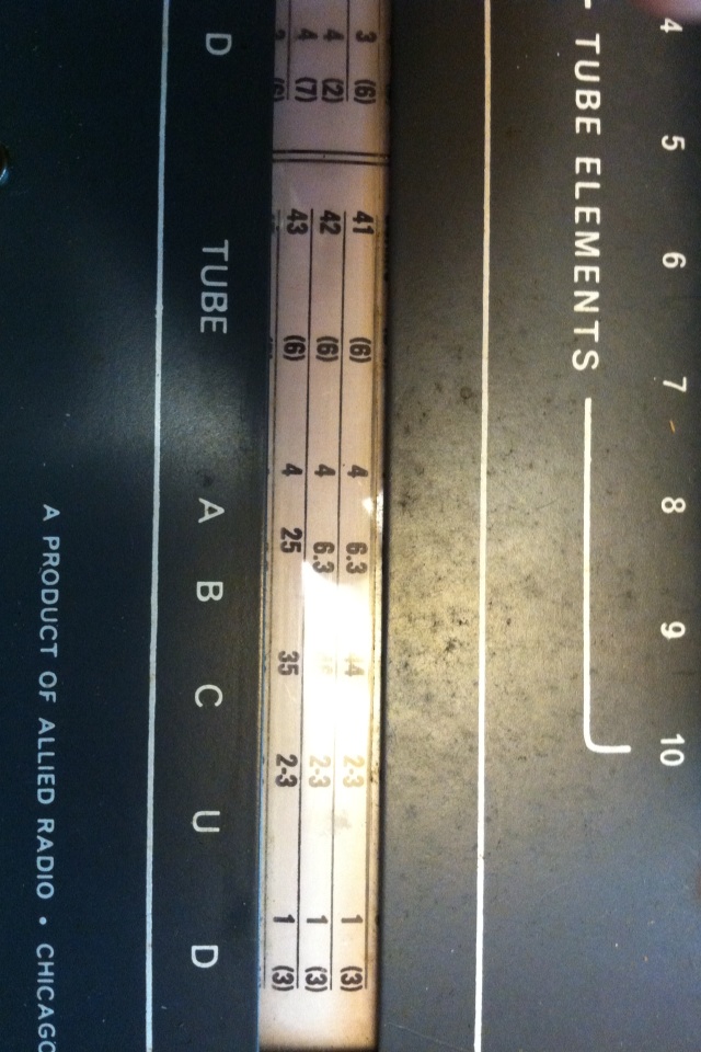

I have the same unit, are you checking the (#) beside tube settings? Every tube will show as shorted for that number switch indicated in parentheses.

Thanks for reply. The instruction does not mention parenthesis for shorts. It says that after setting the U,D and other switches according to the tube #, push any remaining switch up. If any of these switches will cause the neon to glow, the tube is shorted. As per instruction,the parenthesis's are for the gas check only.However, on my rolling chart (the tester came with 2, older and newer,I use older, for ##24, 27, 36, 37, 42, 80 tubes) there are no parenthesis's.
The tester came with a newer roller chart installed. The older one was loose in the box, and to fit it, I had to trim the wooden stick shorter. Is it possible it is from the different unit? It is printed "Knight" on it w/o model#.

#6 lever will show short on a 42 tube. Also, if the short lamp flashes it is just a cap in the unit discharging and should be ignored.

I may have to get different roller chart or the printout booklet. Your instruction is same as mine, the problem is, that my chart does not have those numbers in parenthesis. For the #42 tube, as an example, there is just a line between 42 and 4, whereas on yours you have the number (6). The tester came with different roller chart WITH the numbers in parenthesis,but there are no tube types I work with in there. The chart with my tube types was inside the box, loose. Could be from the different tester and the previous owner possibly used it just for the reference.
