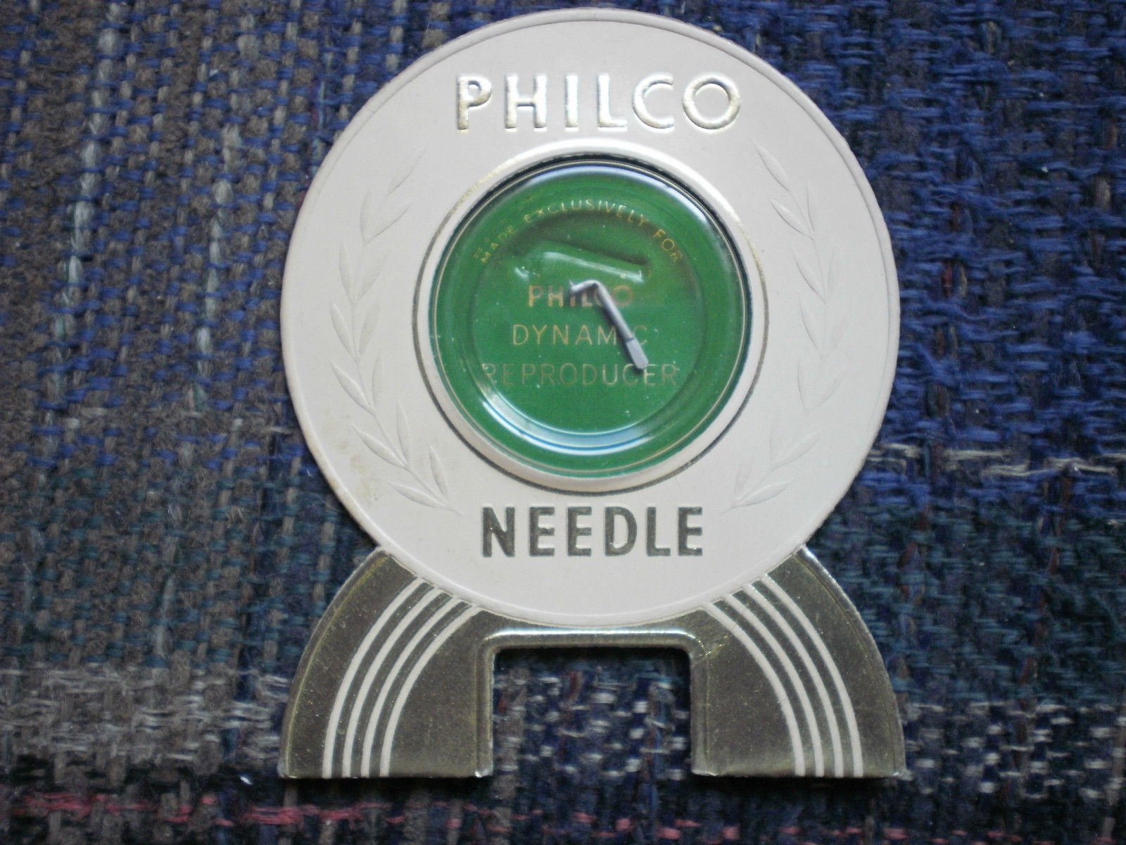

Posts: 76
Threads: 20
Joined: Oct 2010
City: Oskaloosa
State, Province, Country: KANSAS
Posts: 736
Threads: 26
Joined: Jun 2013
City: Hayward, California
Yes, that's the one I bought for my D10a which works perfectly.
