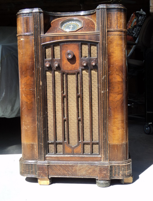

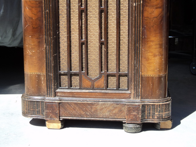

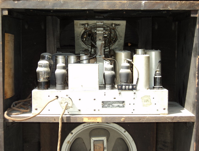

Too bad about the missing and or broken bun feet, that involves finding someone with a lathe to make some reproductions. I would also expect to find lots of rubber wire under the chassis, and hand wired circuit boards crammed in there. What really adds to the effect these sets have is the shading they applied as well as the marquetry.
Posts: 1,470
Threads: 97
Joined: Jul 2012
City: Poughkeepsie, N.Y.

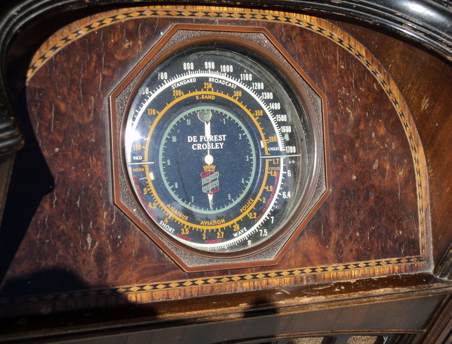

Very nice set. The only problem with the cabinet are the feet. A little go-joe for a cleanup of the cabinet, and restore a finish you might be surprised how that cabinet will turn out. I like the dial on that set easy to read when tuning. Keep us up to date on the progress!

It came with the broken pieces for the legs.. I just have to glue them on and touch them up.
I am not looking forward to the wiring if it is all crumbling.
So far I have not had a lot of problems with real bad wiring
Sometimes I need the parts list for the value of the caps if it is not stated on them. Nostalgia air did not have a parts list

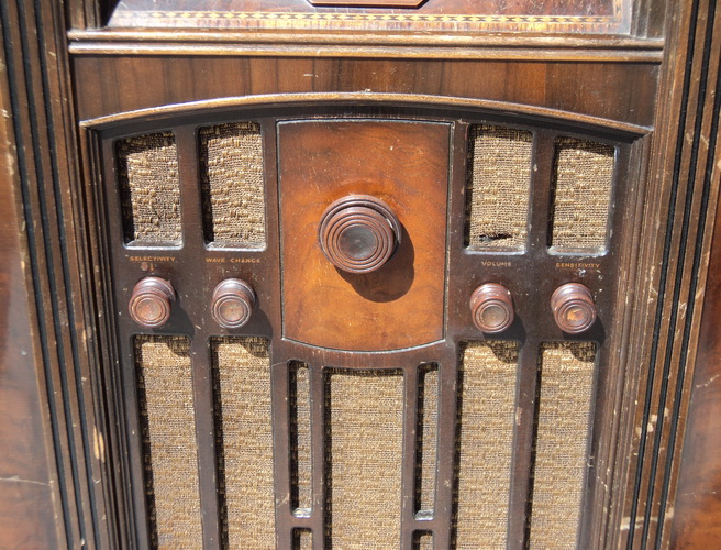

I looked at the grill cloth and it looks like it needs to be replaced. I have not gone over the radio in detail but part of the marquetry on the top left side [facing radio] is missing a small amount.. I don't know if I can get anything that will match although there is an exotic wood supplier in the area.
I will keep you informed and if I need help i will ask for it ..Dan in Calgary
Philco John mentioned restore a finish. but I have never used it but maybe I will give it a try on a scrap cabinet.

I think that I have the Rogers service folder for this set, although it's labeled under Majestic. It is online too but someone forgot to scan the parts list, which you need to identify the capacitor values. Sent me a P.M with your email and I will scan and send the folder. If this set does use hand wired circuit boards the service folder will NOT show a layout of what is on those boards. What's more they liked using resistors with spade terminals on those boards, which also doubled as tie points, which you need to come up with a substitute tie point for if the resistor has drifted up in value. I drilled out the holes the resistors ran through and inserted 1/8'' metal eyelets to use as tie points, unless that tie point also connected to a wire going elsewhere under the chassis.

By the way, make a careful inspection of that Zebrano grained wood around the base before trying to strip, it may be a faux finish rather then real veneer.

I had a good look at the bottom of the cabinet and it is faux, not real wood.. I think I can clean it up so it will be presentable.
