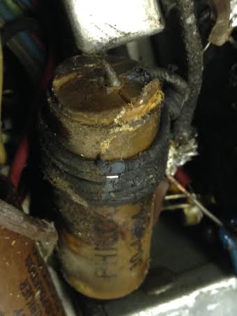

I am working on re-capping this tiny, tight, cramped chassis and one if the caps (.25) is wrapped in wire and then connected.
Why and do I repeat this?

No you don't have to. It's a wave trap for the IF stage.
The cap is AC link between the Chassis and the Negative Common.
It is present in all AC/DC sets. Without it you will hear ghosts, motorboating and howling.
Why a choke....I do not know for sure but as this is a series resonant tank they want zero impedance between the two commons at a certain frequency. Why, don't know, some sort of noise reduction I guess.
Could be a wavetrap as Terry said. Although a cap is kinda large, but then maybe the choke is real smll.

Some people remove it entirely, others like myself melt out the capacitor tube and rewind it with a more modern wire of the same gauge. Given Philco's knack for cost cutting they must have been needed at some point. The capacitor needs to be there, the coil probably doesn't, the coil is in series with the capacitor and is used to couple the chassis to B-, it blocks AC voltage but allows RF to pass.
Thanks guys,
I think I will replace it and wrap it like original
