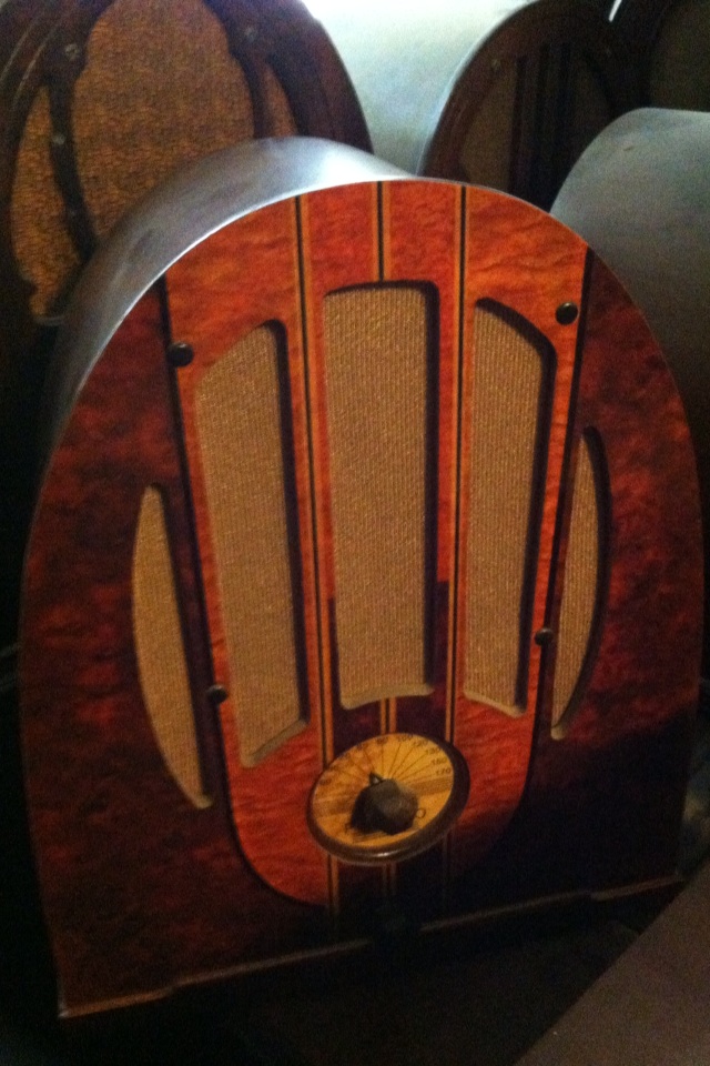

Being paper rather than plastic it would soak in the glue better, The reason I know it will work is that I used this process on my 37-84 but I printed it myself and the colour bled a little with my printer. A printing press could print the image alot sharper and larger.
Posts: 411
Threads: 42
City: Ironton Ohio
Not perfect but it looks better than it did.

Todd,
Thats beautiful!

Thanks kirk
Thats the largest radio I could print to fit. I have about 5 more photo finish tombstones/cathedrals but they are all taller than a sheet of legal sized paper will cover, one of these days I am going to use my own suggestion but without a fitted image I would have to have full sheets of each wood grain printed and cut it out myself, then there would be the problem of the pinstriping.

Tab, is that whole front printed on a piece of paper? It looks pretty good.

It is actually 3 pieces, right and left dark areas and one piece for the middle U shaped piece
