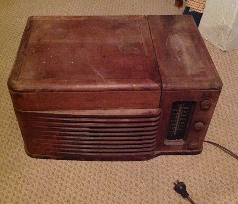

Here is a picture I found on google of the model that I have, hope this helps to narrow it down. Thanks for all of the help so far!
The radio pictured looks like a 48-1256 which uses Philco p/n 34-2477 pilot lamp.

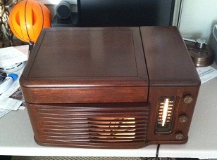

I'm actually in the process of restoring the radio, I purchased it for $25 and it wouldn't turn on when I bought it. There were nests in it and it had been sitting in some garage wasting away. Here is a before and after of the wood work. I also just added a speaker but the stations that come in are so faint over the hum that I have to put my ear up to it. I hope I wired it right, I'm no electrician by any means. I just enjoy restoring older items as a hobby. If I may, I might post how I wired it and see if anyone notices anything funny. The plan is to get it up and running and then put some legs on it so it will be a unique and functioning end table radio.
Looks nice.. In my opinion though I wouldnt put legs on it. If you want it as a sort of end table why done you make a stand for it with a base about the same size as the radio and put the radio on it. That way you wouldn't ruin a nice old radio's originality.

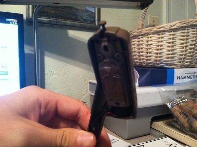

That's a good point actually, I'll put some thought into that. I am also in the process of trying to wire up the phonograph portion but won't be able to test it until I buy a needle for it. Can anyone tell me where to locate one, and if I need anything else based on this picture? I know nothing about these.
I haven't used this supplier but bookmarked him...maybe he has something: http://www.vintagelectronics.com/Lookup.htm
You might want to stick (not frce) a pin in the cartridge, hook it up and scratch it to see if it is still good. Chances are it will not be. Well then you will be looking to replace it. Lots of help available to do this.
