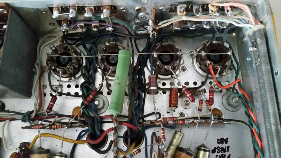

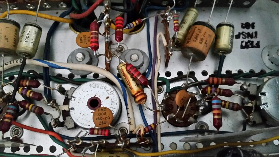

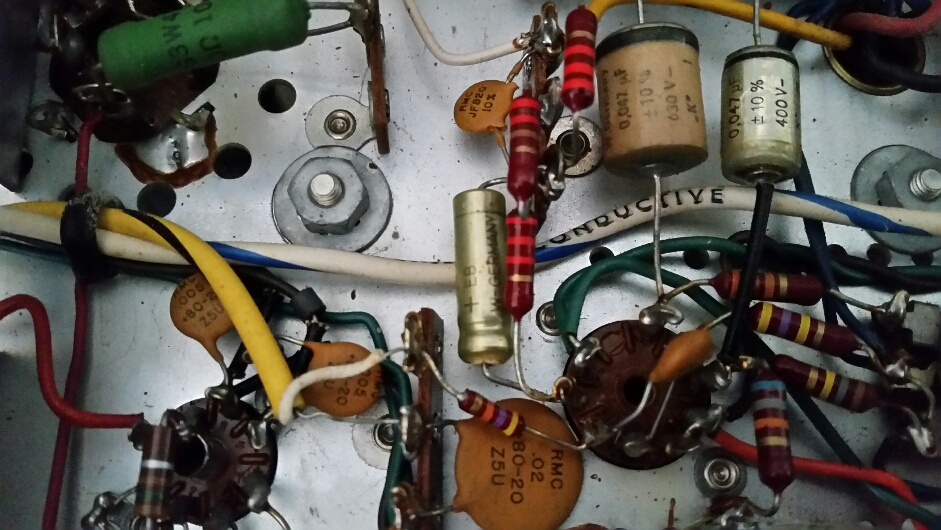

Here are some pictures from under the chassis:
The gold coloured electrolytic here doesn't show any [I]outward[/] signs of trouble... but we all know that tells nothing.
In the other channel, the counterpart to above looks a little less promising, and the rubber seal around the + lead has seen better days.
This guy, who really works in the FM section, was placed near the output valves. Clearly, he's ready for replacement - at first, I had a hard time recognsing him as kin to the others!

I got into the caps today, and replaced those pictured above, and a couple of others. There's one more axial electrolytic to replace, and then we're on to the cans
