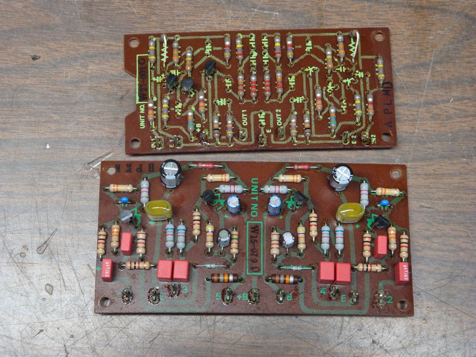

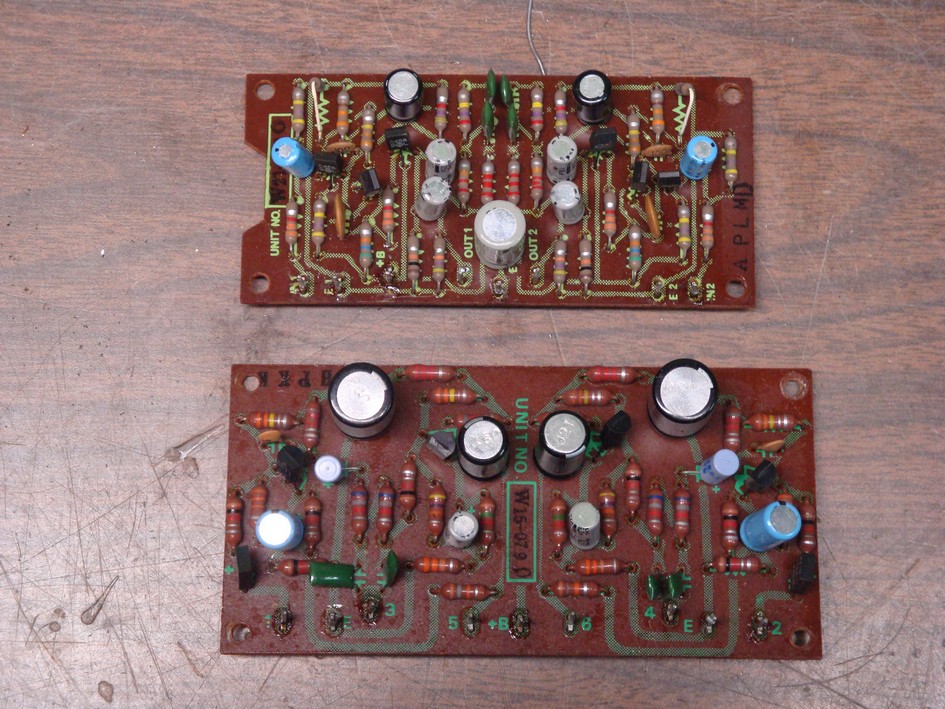

Since I did not have the parts I needed to completely rebuild the control amp board, I went ahead and removed it. Just for fun, I also removed the head amp board (phono preamp). Here's how the two looked when pulled from the receiver:
[Image: http://www.philcoradio.com/images/phorum..._00032.jpg]

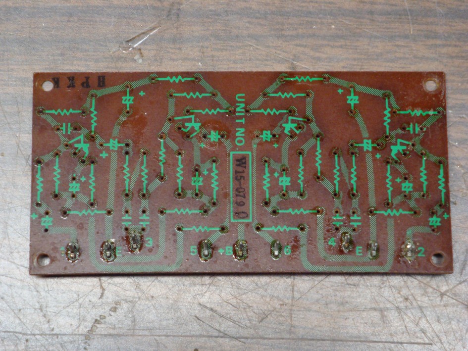

After several hours and more than a few feet of desoldering braid, the control amp board looked like this:
[Image: http://www.philcoradio.com/images/phorum..._00033.jpg]

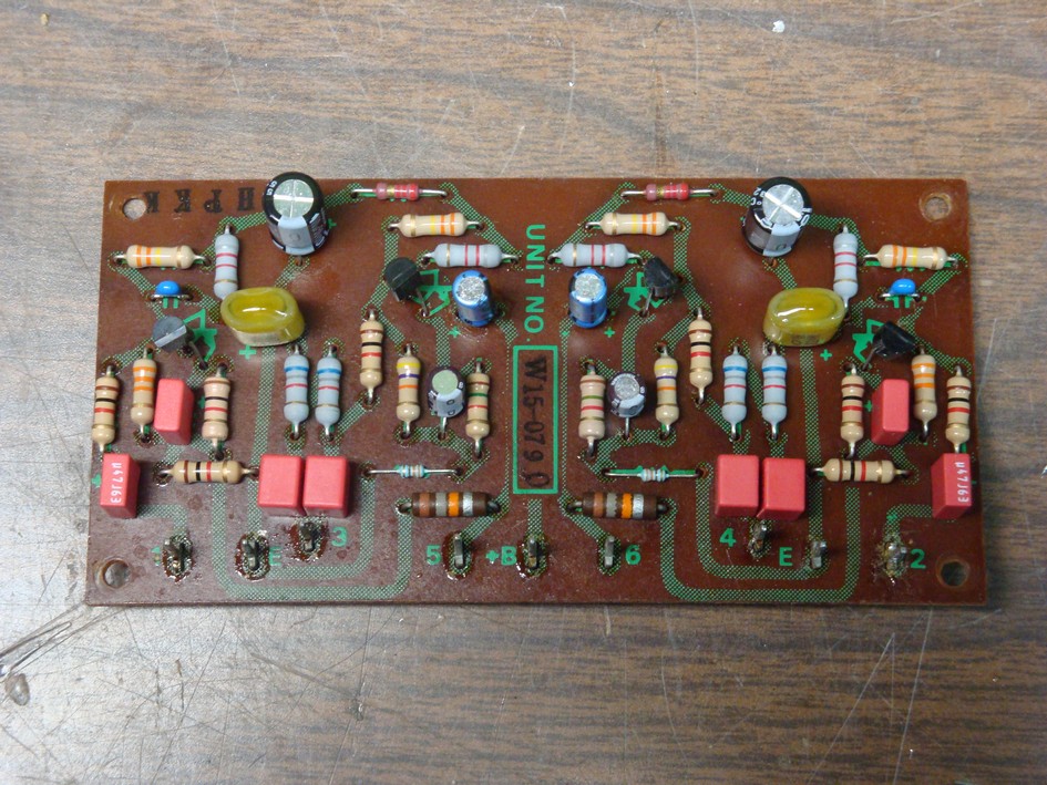

When I was finished by last night, here's how the control amp board looked:
[Image: http://www.philcoradio.com/images/phorum..._00035.jpg]
Last night, I also partially rebuilt the head amp board. This time, I did not bother any of the resistors, replacing only the transistors and all capacitors.
On both boards, any electrolytics of 1 uF and below were replaced with WIMA or Nichicon polyester.
This photo shows the completely rebuilt control amp board, and the head amp board with a few new transistors:
[Image: http://www.philcoradio.com/images/phorum..._00034.jpg]
