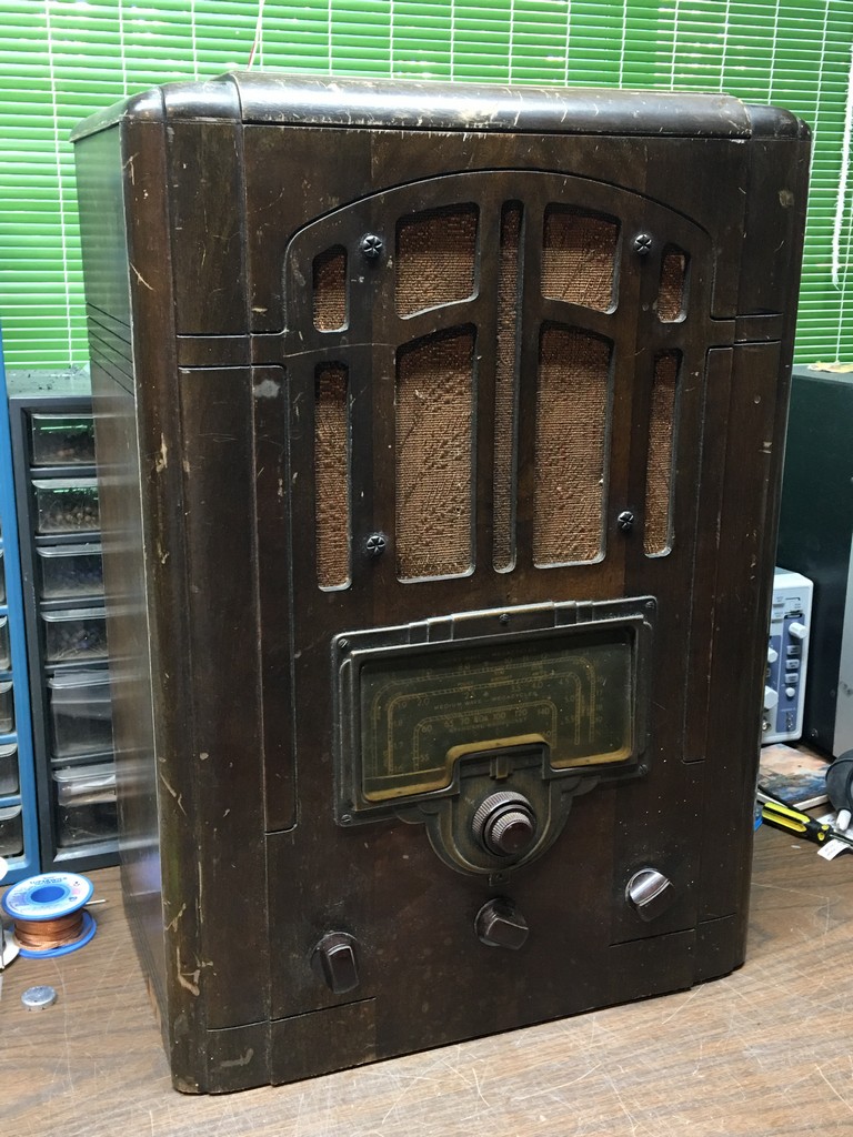

If you remember, I found this RCA Victor 6T2 on the auction site a few weeks ago:
[Image: http://www.philcoradio.com/images/phorum...T2_002.jpg]

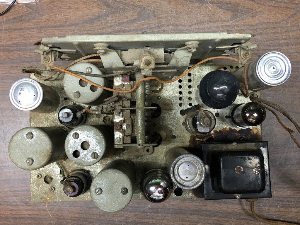

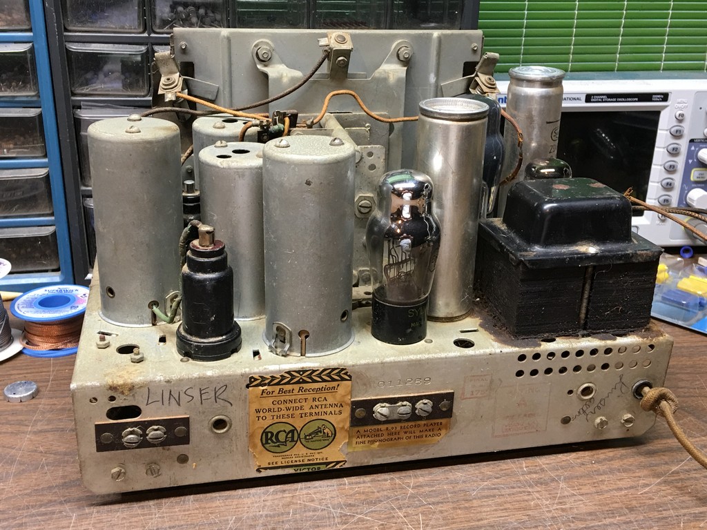

It had lots of dust covering the chassis, but no rust. Here's the chassis after blowing it off with compressed air (outside) and vacuuming it (inside).
[Image: http://www.philcoradio.com/images/phorum...T2_003.jpg]
[Image: http://www.philcoradio.com/images/phorum...T2_004.jpg]

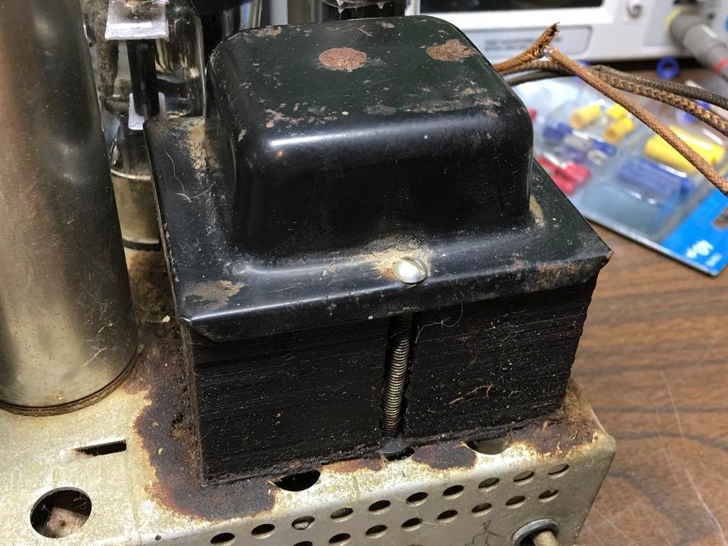

The power transformer may have a problem.
[Image: http://www.philcoradio.com/images/phorum...T2_005.jpg]

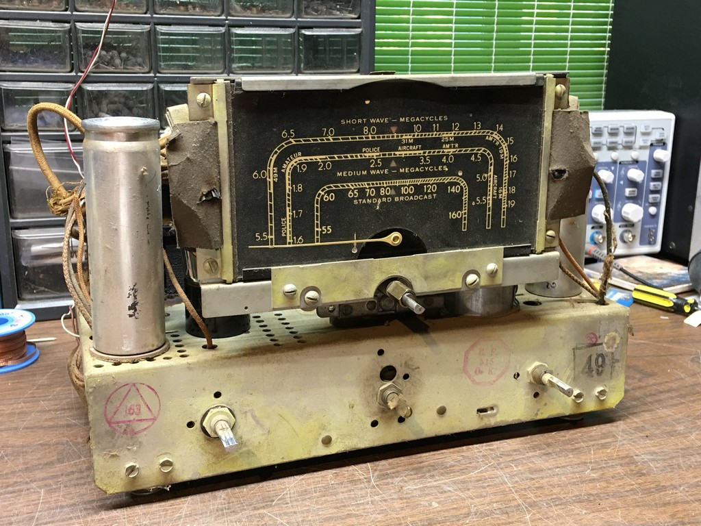

Top view:
[Image: http://www.philcoradio.com/images/phorum...T2_006.jpg]

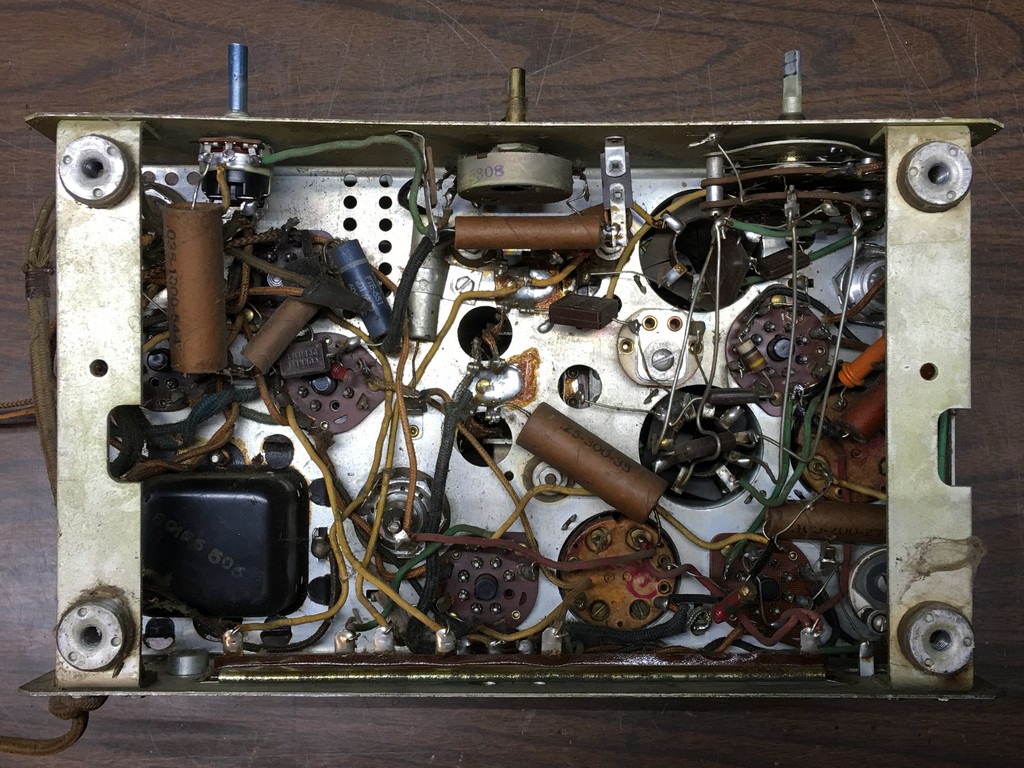

and bottom:
[Image: http://www.philcoradio.com/images/phorum...T2_007.jpg]
Yup...more rubber-covered wiring. Some of the original paper capacitors were replaced over the years, but the originals look good enough to restuff - they aren't falling apart as were the capacitors in my RCA T7-5.

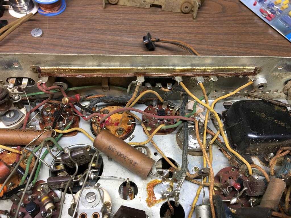

This RCA has a single, five section Candohm - R14, R15, R16, R17, R18. This is mounted on the inside of the back of the chassis.
[Image: http://www.philcoradio.com/images/phorum...T2_008.jpg]
Naturally, one section is bad...the one in the middle above...R15 (13K). The other sections are still good. All five will be replaced.
That presents another problem...just how shall I go about replacing this Candohm with terminal strips without having to drill holes through the old stickers on the back of the chassis?

On my 37-2670 I mounted the replacement resistors on a sturdy aluminum plate, using flat-head machine screws so that the heads would be flush with the aluminum backer.
I then mounted the whole assembly using the original holes for the drilled out rivets.
It looks like maybe you could do something similar here since the rivets are exposed (not covered by stickers AFAICT).
Say, that's a good idea!  Thanks!

The paper labels will come off with acetone, if need be.

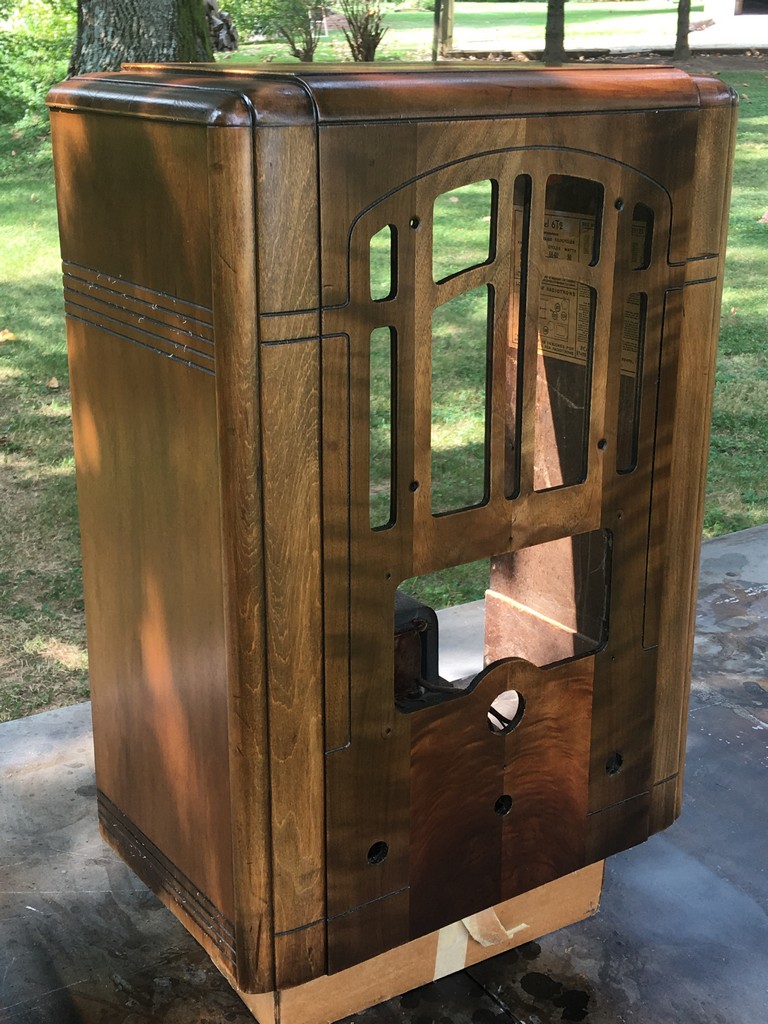

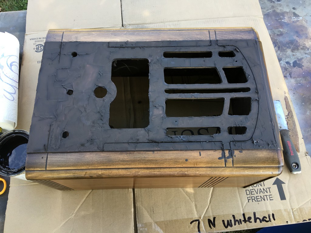

Three weeks and one day ago, the 6T2's cabinet was stripped.
[Image: http://www.philcoradio.com/images/phorum...T2_009.jpg]
Today, I patched the missing veneer on the bottom of the left side, sanded the cabinet down, and sprayed on the sanding sealer.
[Image: http://www.philcoradio.com/images/phorum...T2_010.jpg]
I made an unfortunate discovery during this: Apparently, Mohawk cans will go bad after so long. I found this out when the sealer blushed a little and I went to get my handy-dandy No Blush Plus - it would not spray properly. Replacing the nozzle made no difference. So this means another can needs to be ordered.
Hopefully, tomorrow evening, depending upon the weather: Grain filling of this cabinet.
