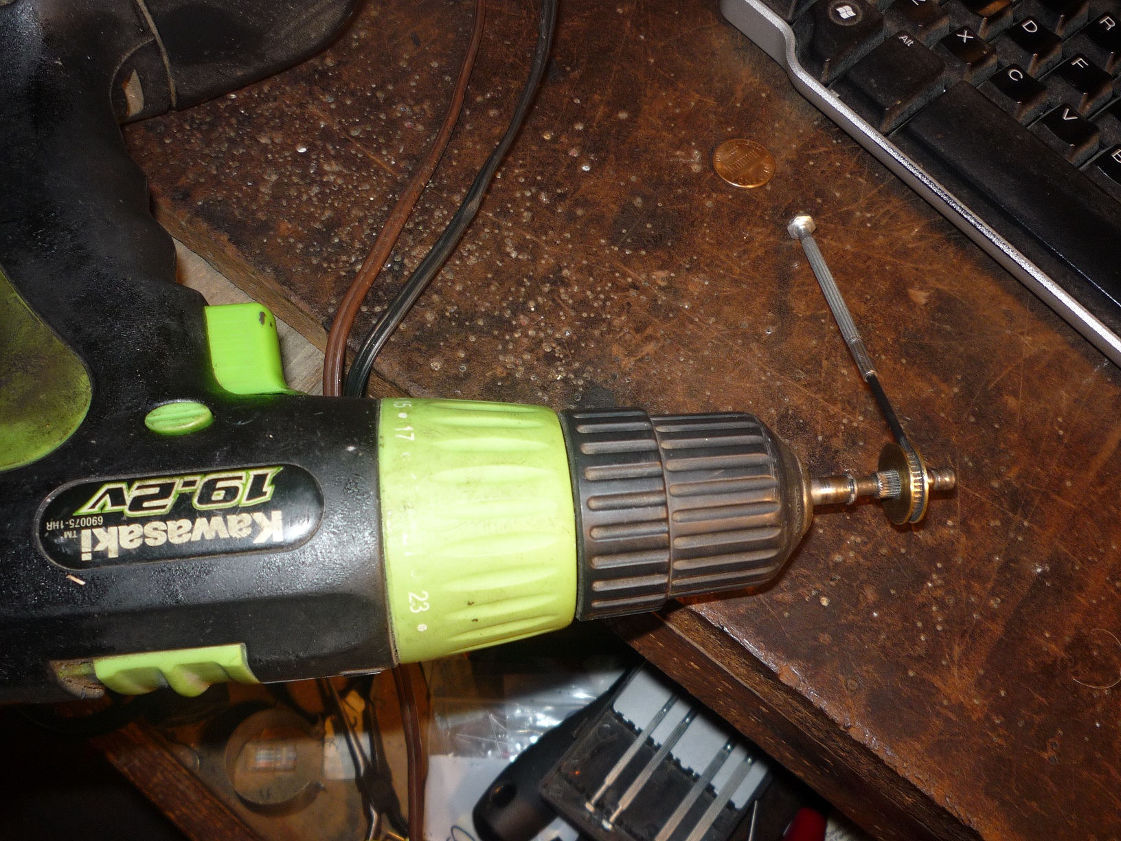

So my shadow meter tests well, so i moved on to getting the tuning wheels  ready to restore.  After i chipped off as much of the old rubber as i could, i inserted them into a cordless drill and used those dollar store mini screwdrivers to whittle  down the remaining rubber in the grooves. (A mini lathe if you will)... A little sandpaper and wire brush to finish. Took very little time to get it down to the metal slats at the bottom...
  Will the remaining residue in the grooves have any effect on the new o-rings?
