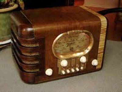

Here is a photo of how the radio is supposed to look originally (borrowed from the web)..
You can see the zebrawood stripe on the right edge of the cabinet.

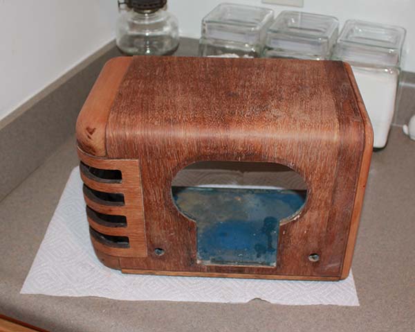

Here is my project radio, stripped and ready to become a victim..

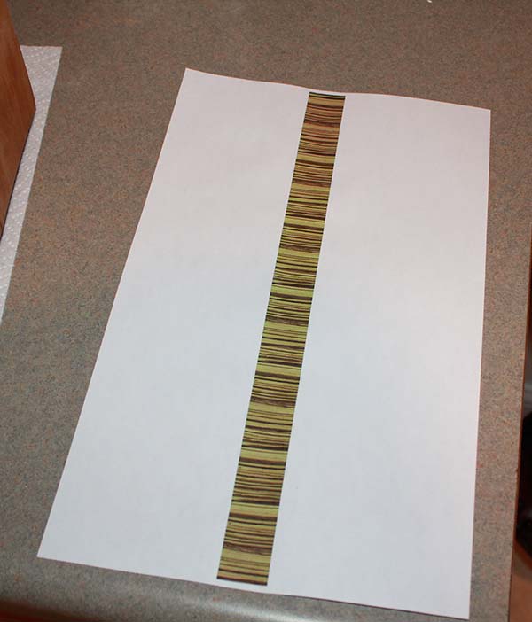

The first thing I did, was a Google search for Zebrawood. I found hundreds of images. You can find images of any kind of veneer you want. I ended up choosing one, right clicking on it, and saving it to my computer.
Then I loaded it up in Photoshop. You can use MS Paint, or any photo program that will allow you to edit JPG file.
I cropped the photo to use the section that I liked. The original stripe measured exactly one inch wide, so I edited the size of my stripe and made it one inch wide. Then, I copy/pasted to make it 17" long.
Here is the file I used..
(This post was last modified: 03-17-2014, 04:04 PM by Jamie.)
Posts: 761
Joined: Jul 2013
City: Kentucky

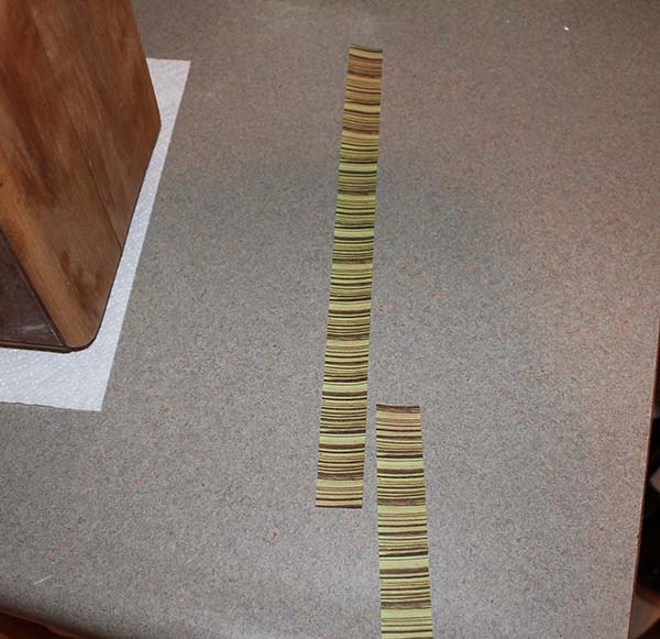

Next, I printed it out on my ink jet printer.. It took two pages because my paper is only 14" long.
Then I cut it out....
Now, I tested this on a scrap piece of wood first. If you try this, I recommend you practice a little as you go along...

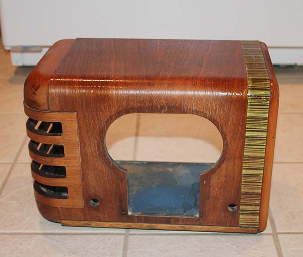

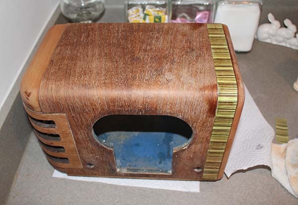

The practice session seemed to go well, so I decided to proceed. I used Elmer's Wood Glue, and spread the glue all over the back of the stripes. You cannot miss even a small area, you must coat the back of the paper entirely. ...
Then I stuck it on the cabinet...
Posts: 761
Joined: Jul 2013
City: Kentucky
Once you have the paper in the proper position, it is very important to squeeze out the excess glue. Just use your finger and make sure all the edges are glued down and there are no air bubbles. Clean up the excess with a damp paper towel. Then allow it to dry.
After it dried, I decided to coat the cabinet with sanding sealer. I do not know how ink jet inks react with lacquer. I always worry about fisheyes, or perhaps that the ink would dissolve and run. So, the next step was a nice coat of Mohawk Sanding Sealer..
(This post was last modified: 03-17-2014, 04:05 PM by Jamie.)
Posts: 761
Joined: Jul 2013
City: Kentucky
Alright.. lookin good!..Allow it to dry! ...

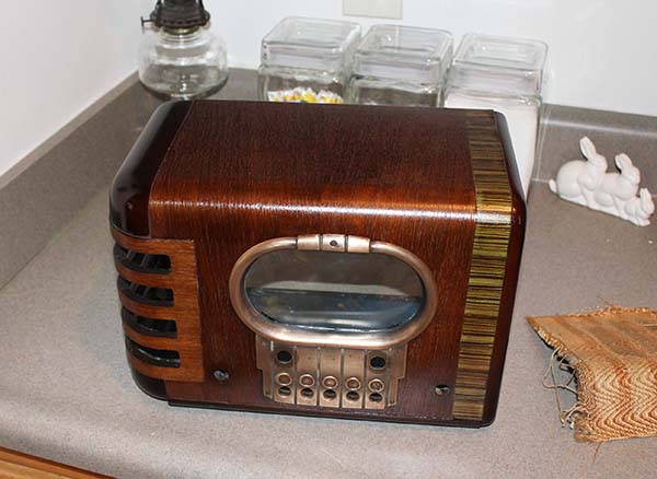

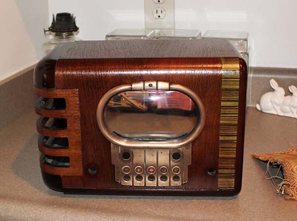

Next up was just to use regular refinishing technique. There are already threads on this, so I will skip those steps. Basically, I sprayed a light coat of universal walnut over the entire cabinet (including my paper finish.).. Then, I taped off the main cabinet and did the edges with Extra Dark Walnut. This was followed up with a few coats of Clear Gloss.
Final Result....

Original look that was desired...
Not too shabby!..
