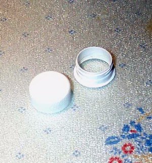

When done, cut out the plastic spout and cap:
[Image: restuff_can_2.jpg]

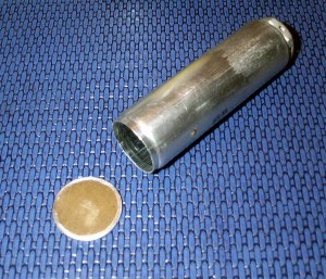

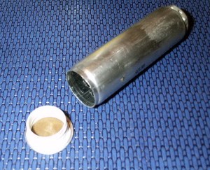

Cut the electro using a sharp Olfa Blade. Rock the cap under
the blade while giving slight pressure. Once the blade cuts
through a small portion, roll the cap until completely done. It
will make a perfect hsarp cut everytime if you go slow and do
not put too much pressure as to dent the aluminum can.
[Image: restuff_can_3.jpg]

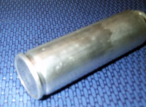

Glue the spout to the top of the electro:
[Image: restuff_can_4.jpg]
The cap will be glued inside the can cap. In the picture I cut the
cap to seee through but it is not needed. Use a hot glue gun to
attach both spout and plastic cap to can capacitor.
