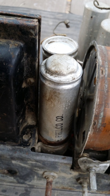

"They Plump When You Cook Them"
For all of you guys that "reform" electrolytic caps, make sure that the form that they take is not this one.
"Yes officer, he was killed by a IED". Improvised Electrolytic Device.
Phlog, that is what I would call a "reform". Nice job. Icon_clapIcon_clap

Was that indeed a recently reformed cap or it has been this way awhile.....40-50 years perhaps?
I don't reform electrolytic caps. When they are bad they are gonna' swell up and pop. At least that one would render soapy water and some aluminum shrapnel, where as the dry caps have you cleaning up gooey paper everywhere.
Well, reforming of new caps simply puts them against the working voltage and the rate of current drop is watched, and the old ones are put via large value resistance so if the cap shorts the current is in single mAmps.

Of course I would not try to fire up one of these old timers anymore. Please, everyone don't do it, Many of these sets were not fused, and fire and injury risks aside, expensive/irreplaceable transformers may be destroyed in the process.

I do not reform old Philco caps from 30s or 40s. Especially in view of the fact they have no capacitance left due to drying.
