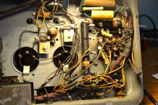

Thanks for adding me to the group. I've learned from numerous threads here, and wonder if anyone can tell me if I'm seeing what I think I'm seeing on this chassis. The power transformer has 12 terminal lugs and they are arranged (with the chassis's controls pointed to the ceiling) 1-4, 5-8, and 9-12 corresponding to the labeling on the schematic. On this chassis, the last four lugs have no wires attached so the leads that provide power to the rectifier are not connected to the power supply. Instead, a Philco part 32-7180n listed on Playthings of the Past as a power transformer is bolted to the chassis between the choke (a 3422) and the first by-pass condenser. In addition, some past technician placed a pair of 8uf electrolytics on the lugs for the filter capacitors. I should also mention that lugs 9-12 on the power transformer show open on my DMM. I can not find a part 32-7180n on the schematic, so I'm guessing the guy who tied electrolytics across the lugs of shorted capacitors tried to power the "D" and "E" lines separately? The thing is, except for all the electrician's tape on the leads coming out of the 32-7180n, the mounting looks original.
The schematic is at http://www.philcoradio.com/tech/images/77.jpg
Thanks for the wisdom in advance.

Power transformer has a bad secondary (lines 9-12) everything that supplies the 80. I was using the needle probes when I looked at that. It's sad. I got excited getting good ohmage on the windings at lugs 1-8. That is why that repair person in the 40s or 50s added the second transformer. I can't imagine how much power the set used with two power transformers. The 32-7180N was only connected to the rectifier and to the mains and the pilot light (wrong in the first place). All the other windings test good, though. I put the set back in the chassis yesterday, but I will take it back out and start over this evening. The soldering that guy did is a mess as well. Big, gloppy misshapen masses with untinned leads everywhere he worked. The good news is that he only worked at the power supply end. No changes past the capacitor block at all, but time has not been kind to the wiring above the chassis, so I will need to do some careful tracing around the pilot light/tuning cap/volume pot areas.
