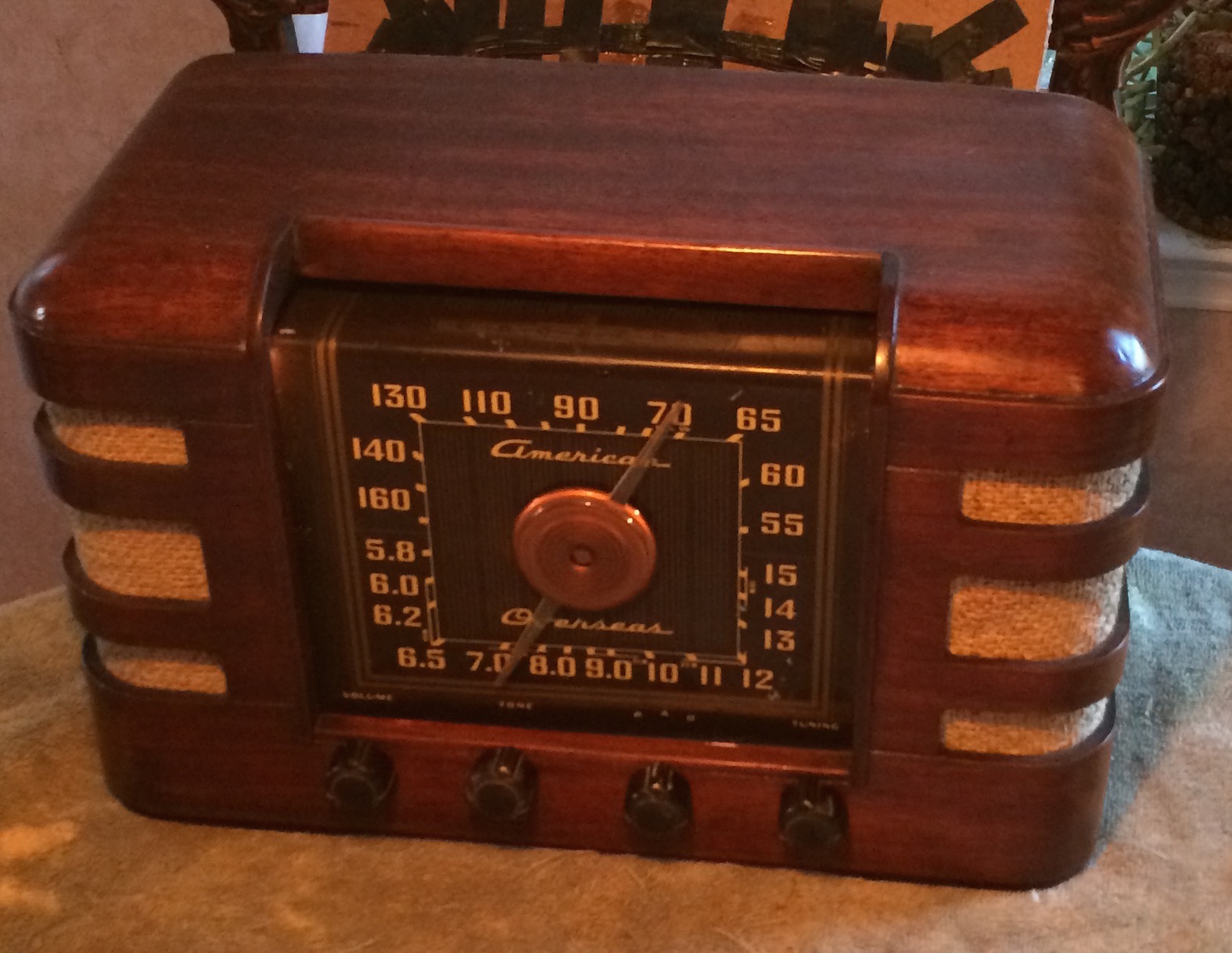

By the way, I put the adapter together with the Radio Shack audio transformers and hooked it up to my Crosley 66TC which has a phono connection and a bandswitch setting for it (the setting seems to cut out the RF stage and send the phono signal to the detector). It worked very well, sound levels are perfectly balanced to the volume of the set itself. The whole thing is about the size of a pack of cigarettes. So now all I need is another American Overseas set (because she's not getting mine), and my daughter can have the antique radio IPod dock she wants. ;)

I couldn't bring myself to do it. One of my primary motives for doing this as a hobby was to help preserve the history if I could (that and the idea that it is a bit electronics and a bit furniture finishing).
I kind of pushed my daughter toward the Crosley 66TC because I had already worked on that chassis, and I knew I could put one together for her, AND it had a dedicated phono circuit, AND I happened to already have a spare Crosley 66 chassis laying around. It turned out she liked the looks of the cabinet about as well as anything I had worked on so far which is a small problem because I was counting on being able to source any of the three cabinets for the chassis, and now I have to find one of the wooden ones. Ah well.
I've found a dial cover since this photo was taken.
