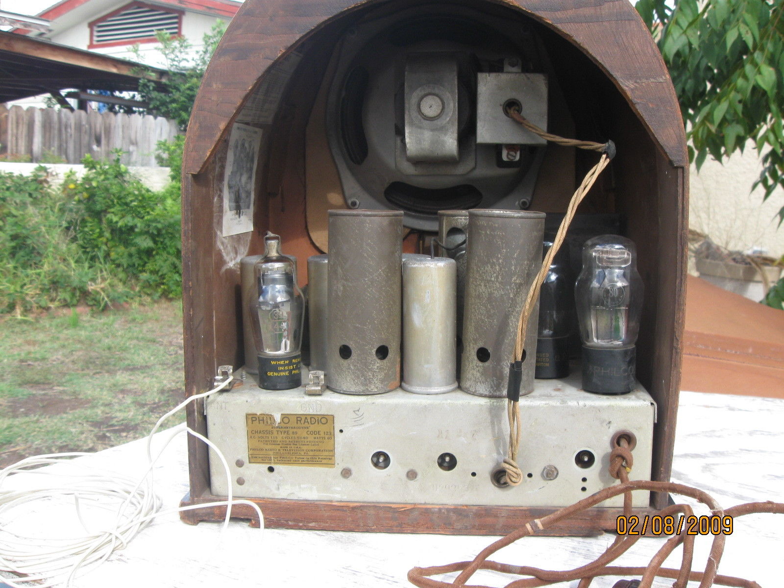

Here's a picture of an 89B harness (not entirely faded):

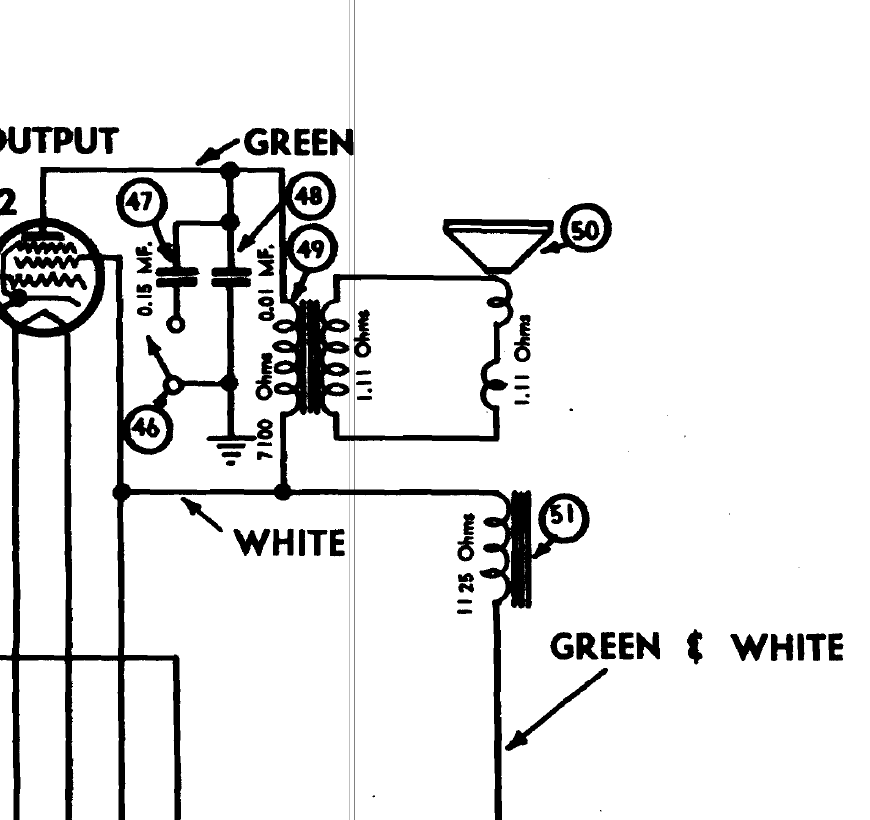

And according to the service bulletin (#146B):
So the wires are green, white and green & white.
