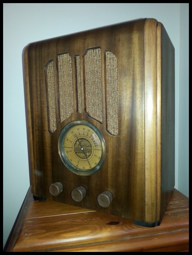

Yesterday I thought I would see if I could do a 1-day project and get one going and looking ok.  One day?  What was I thinking  Icon_lol
I picked the one with the better cabinet, and grabbed the stripping gear - no, not the velcro pants and clip on bowtie... paint stripper and acetone... get your mind out of the gutter.  Wait, what do you mean I was the only one thinking that?... ok, its late... I should stop waffling now... any time now... please make it stop...
Anyway, a couple of hours later I had this:
[Image: http://i241.photobucket.com/albums/ff222...dkcgse.jpg]
Please don't note the stain from spilled acetone on the grillcloth.  It survived 80 years and then some idiot wrecked it by being careless.  I still want to kick myself.  The acetone practically just ate the gold weave and disolved it... leaving holes.  sigh... so I ended up having to take it out.
as this was an exercise in speed with some care and minimal attention I didn't want to do too much to the cabinet.  Actually I really prefer to leave some life in it so the dings and scrapes were left as-is.  I simply painted the black trim black again, and gave the whole cabinet a really good going over inside as well as out because a bird had sat on the OP TX and power-pooped down the inside of it! (to say nothing of all the rodent poop in the bottom)
[Image: http://i241.photobucket.com/albums/ff222...soedwj.jpg]
I then put some new felt feet on it, shellaced the whole thing, and hit it with the dark oak Briwax.  Thats it, done.  By lunchtime.
[Image: http://i241.photobucket.com/albums/ff222...atx09v.jpg]

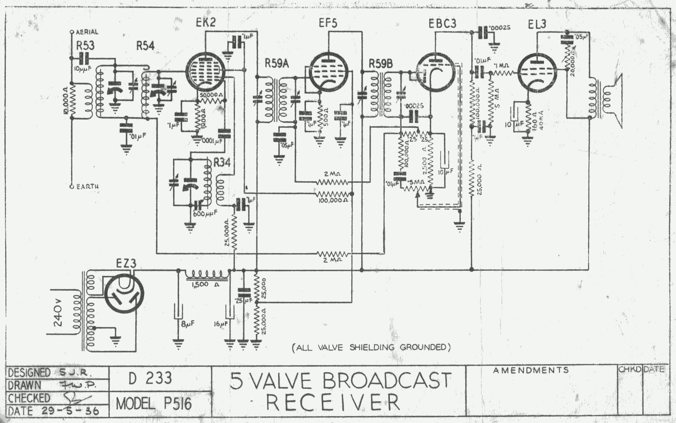

I'm building up a schematic for it too since there isn't any service info for this model anywhere.  Its mostly done but its considerably more time consuming and mind-bending than following an existing schematic to rebuild a chassis.  Its also made slightly more complex by using Philips tubes and style which does not follow what I'm used to.  I'm getting there though.  Having two chassis' helps and hinders since there are subtle variations.  A friend also has one, but his uses gold series 4V valves rather than the red series 6.3's so thats another variation to consider.

Done with the schematic... its taken a while, but now at least there is one... E&OE! Icon_smile

Well, I got a bit carried away with the cleaning... the yellow stuff (nicotine?) takes a bit of getting rid of... and rust remover and a cotton bud is the easiest way I've found (phosphoric acid)... I went through about 100 cotton buds cleaning and derusting this... took a good few hours.  So much for a quick turnaround resto...
[Image: http://i241.photobucket.com/albums/ff222...ycapcf.jpg]
But bench testing proved that its working nicely... and a seat-of-my-pants alignment showed it was well off... and its quite a good performer now.
[Image: http://i241.photobucket.com/albums/ff222...vd0szi.jpg]
So a quick clean of the knobs in the ultrasonic cleaner while screwing the speaker baffle back in with the new speaker attached and bolting the chassis down... then all back together and powered up for the first time in a few years I would imagine.
[Image: http://i241.photobucket.com/albums/ff222...chxx9p.jpg]
The speaker that was in it was very scratchy and distorted... I think it needs cleaned and the cone realigned.  The speaker from the other one sounded pretty good considering it only had about 1/3 of its cone... so I might try making a new cone for that one at some point. Anyway, I have a spare 8" Rola speaker that fits perfectly for now so thats what it got.
[Image: http://i241.photobucket.com/albums/ff222...eimuvc.jpg]
I'm really stoked with it... It needs a few polishing details and it has an instability problem - there is a shield on the EF6 IF amp, and without it all you get is motorboating... and even with it sometimes it breaks.  I may try another valve if I can find one... otherwise it is what it is.  I also think its got the wrong rectifier in it - Its got an EZ2 and I suspect it should be an EZ3 as the EZ2 is an automotive tube and most circuits I found with a similar lineup use the EZ3... still, it works and the voltages are about right.
[Image: http://i241.photobucket.com/albums/ff222...ltiyy1.jpg]
Yes, I need to clean the valves - forgot to do it in my haste to get this 1-day project finished (in about 4 days... not bad! Icon_smile )
And the dial looks great if you don't notice the bit of grill cloth fur hanging down in front of it  Icon_redface
[Image: http://i241.photobucket.com/albums/ff222...7iyyfd.jpg]

A quick final note on this set - a few days after I finished hand-drawing the schematic out (4 days of back-and-forth checking and drawing and redrawing) the librarian from the NZ Vintage Radio Society emailed me and said, "Look, we just took possession of a collection from an old retired radio serviceman and he had a great collection of Philips stuff - is this the radio you were looking for?"
So that was nice Icon_smile
