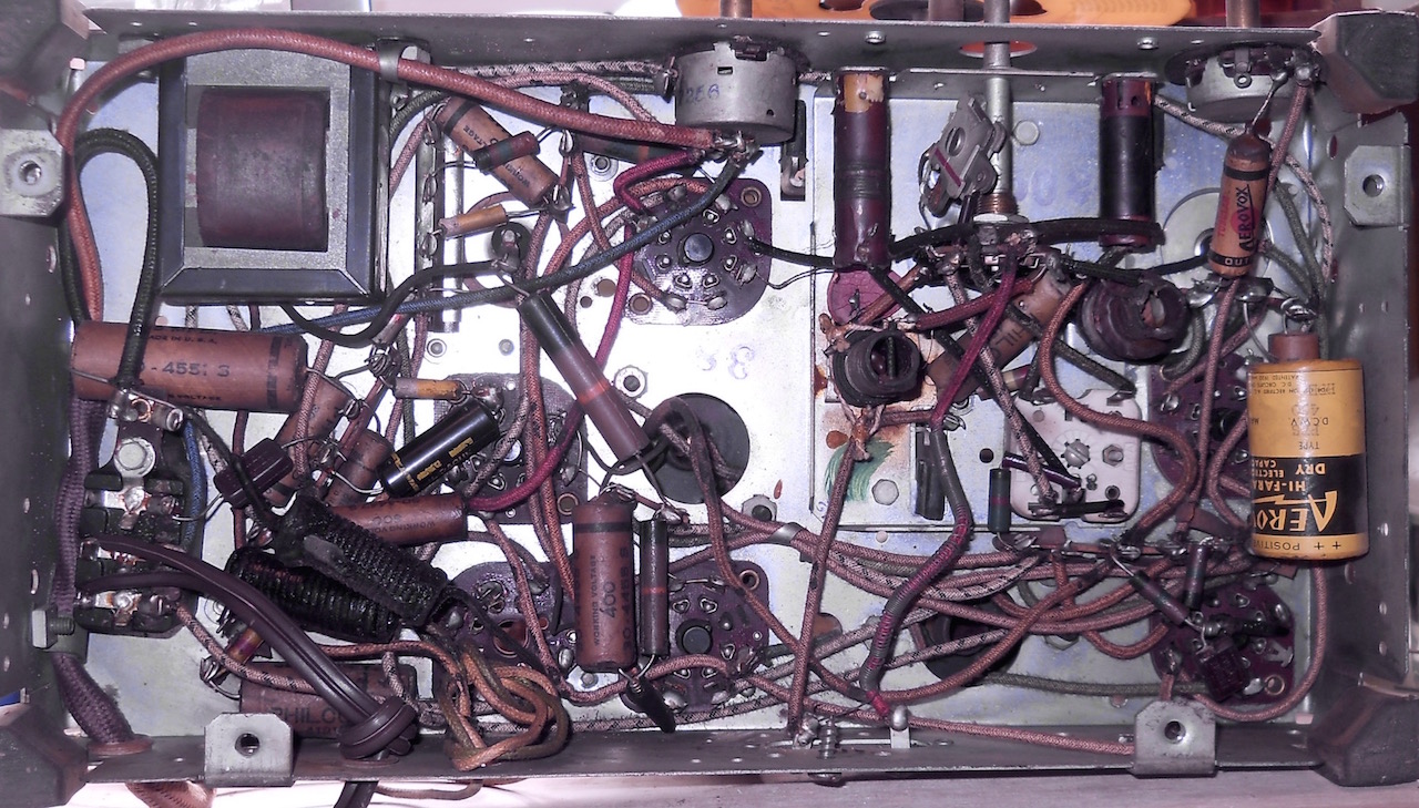

My first problem is looking at one of the can capacitors. Can #14 (30-2291X) someone had cut the yellow wire coming out of the metal tube capacitor leaving the black to go to common negative/ground and Green seems unchanged. The “Can” had the specs of what was in it, but appears to have been rubbed out, maybe on purpose. It is #14 on the schematic with 3 wires coming out, Black, Green and Yellow. I think it says on the side of the Can; Green is 8 MFD 350 DCWV and Yellow is 8 MFD 475 DCWV, Black as mentioned, is Common Negative.
My guess is that one of  Electrolytic Capacitors, inside the #14 Can has been replaced with the big yellow 20 MFD Electrolytic Capacitor that has been added under the chassis. This big yellow capacitor is not shown on the schematic, it has a patent of 1933 so it is pretty old.  On it is written "Type PRS, For rectified A.C. or Pulsating D.C circuits only",  (makes sense as this is a duel power radio), also is "Dry Electrolytic Capacitor,  MFD 20 Max SGEV 525, AEE-6  DCWV 450".
My question is; Are the Electrolytic Capacitors special for this radio as it operates with both AC and 6V DC vibrator power supply?  Or can I just replace with a regular EC of similar voltage and MFD?  Why is this large yellow capacitor so much bigger, 20 MFD than the 8MFD it would have replaced?

Repairs to electrolytics were often made by clipping the lead to the old cap and tacking in a new one of equal or larger capacitance (probably depending on what the repair guy had in his shop at the time). Nothing special about the electrolytics so you could use 8 or 10 uF at the proper voltage rating. Some suppliers: http://www.philcoradio.com/resourceb.htm#n
