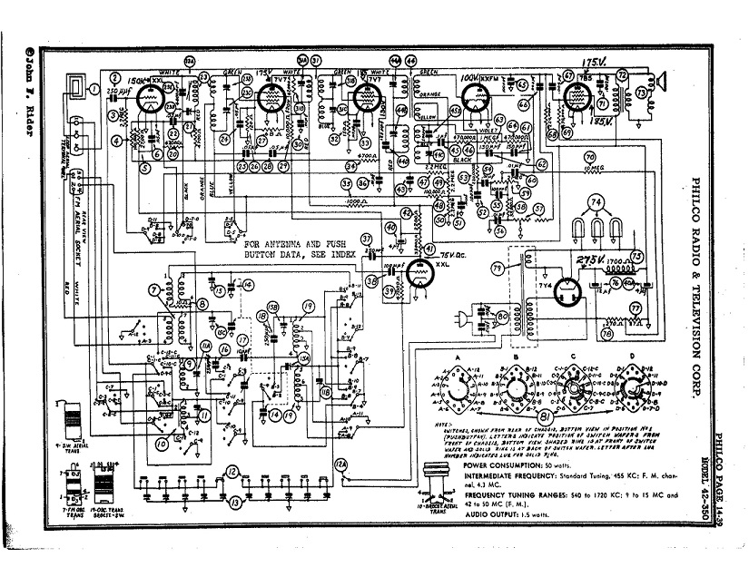

After a recap / resistor replacement, I'm faced with garbled sound on this set. It seems related to the antenna somehow. When I touch the antenna, which should make the signal stronger, it makes the sound louder but even more garbled. I did the obvious....replace tubes with known good one's one by one and no change. I even tried reversing the antenna wires where they attach to the chassis again with no change. Anyone have an idea of what could be the culprit?
Here's the sch:

Greg, Did it play before the recapping? I'm sure you did the other obvious of checking connections and solder joints. Do you have enough tubes of known goodness to replace them all? You could have more than 1 bad tube. An alignment may also be a culprit. Joe

Thanks Joe. I actually tried two different tubes known good tubes in each socket. I did perform an alignment to no avail. Will try some more poking around to see if something may be loose other than what I replaced.
