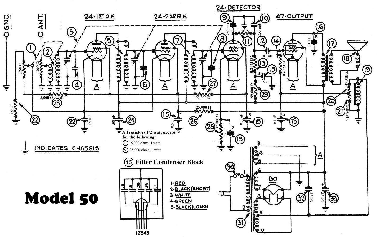

Thanks for this great restoration thread Bob. I just started on a Philco 50 and your detailed restoration is a great help!
Do you know the pin-outs for the bypass capacitor block (No. 15 - Part No. 03459)? The schematics I've seen (service bulletin #86, Riders, Beitman's) list values but don't label the block or the schematic.
I'll post some pictures from mine soon too.

Ah ha - fortunately the 'Internet Way Back' has a reference to the annotated schematic.
https://web.archive.org/web/201603061325...schema.htm
So that helps!

Great find! The cap block just had wires coming out of it as labeled on the wayback post.
http://philcoradio.com/phorum/showthread...#pid111946

I have a phlico 50 that someone has tried to do a restoration.
Wrong Caps & some missing, especially from the #15 Cap Can. There is no can now, which complicates things & tracing the schematic some of those caps are missing.
I know the values for the caps that were in the can.
What I would like to find out is, have you marked a schematic to show which values go to the #15 caps on the schematic?
Thanks so very much for the Help
Jason
Posts: 5,017
Threads: 267
City: Bandon
State, Province, Country: OR
Jason, I think this will answer your question. Ron has a number of marked up early schematics in the Tech Section.
http://www.philcoradio.com/images/phorum/schem/50.jpg

Woohoo! Thank you so much Bob. I didn't think to check in the tech section. I am so very grateful to you for pointing me in the right direction.
Now maybe this 50 will actually work with right caps, in the right places.
Thanks Again!
Jason
