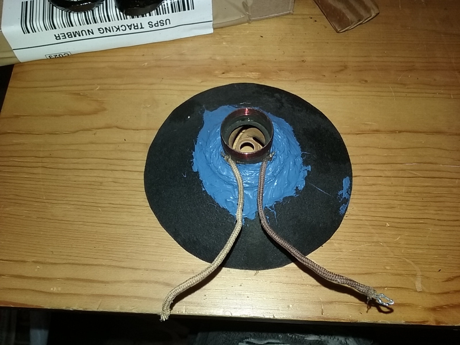

Well I ended up doing my own repair.  I was able to salvage the rigid part of the cone, bought a rubber speaker surround and glued it all together.  It really sounds good now.  Below are some words and pictures showing the process:
Bill

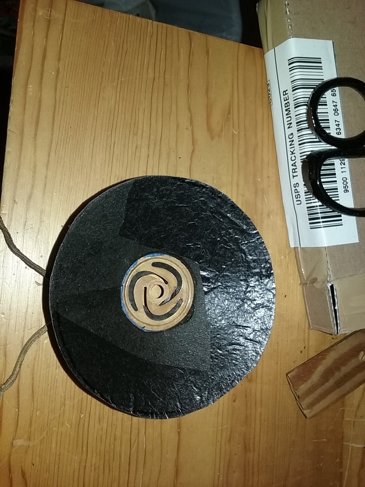

Repaired bottom of cone near coil with RTV Silicone Gasket Maker.  Verified clearance of coil in frame prior to silicone drying.
Top view of cone after repair

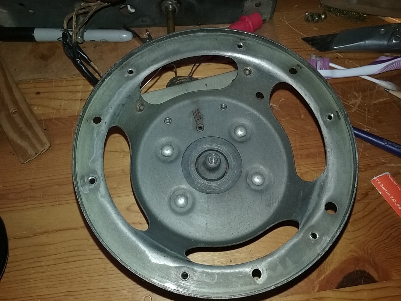

View of empty speaker frame

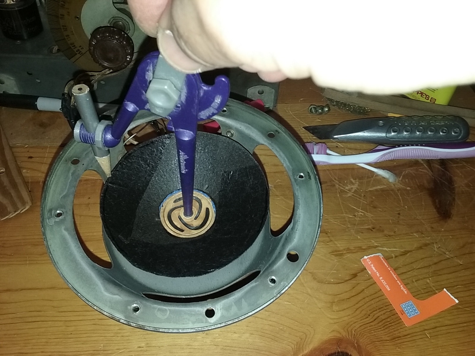

Used compass to mark where cone needed cut to match speaker surround inner diameter.

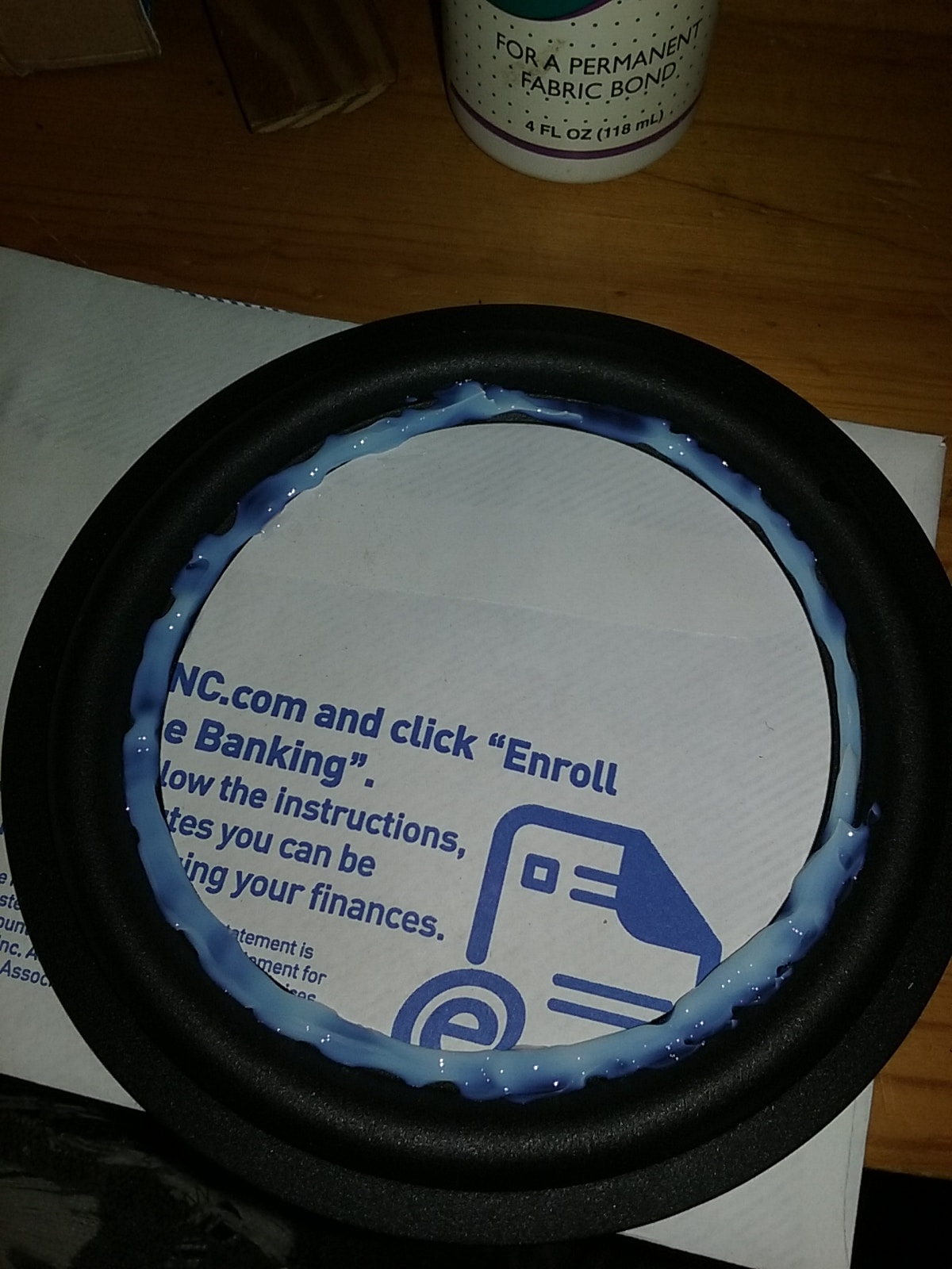

Applied glue to inner edge of speaker surround

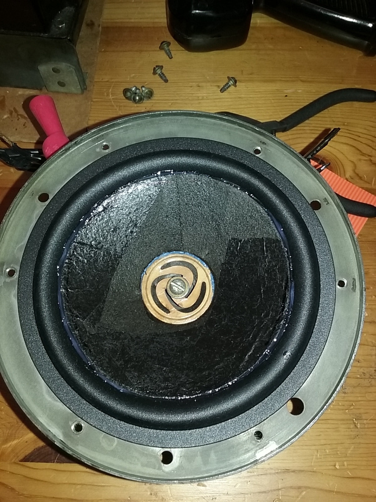

Mounted cone in speaker and centered surround in frame while glue was wet.  Checked that speaker coil clearance was still good.
Speaker after glue dried

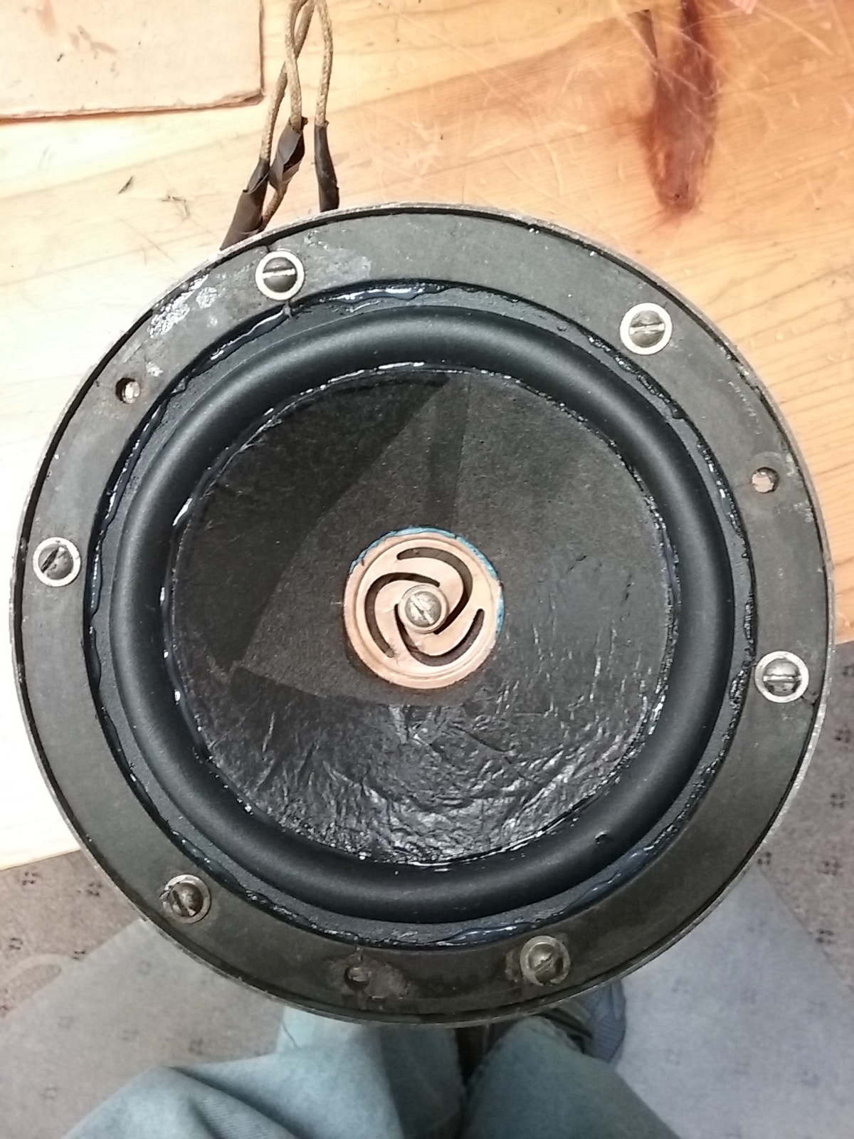

After glue on inner edge of surround dried, glued the outer edge to frame and the spacer that covers it.  Here is a picture of the repaired speaker.
Looks HI-FI Icon_smile
