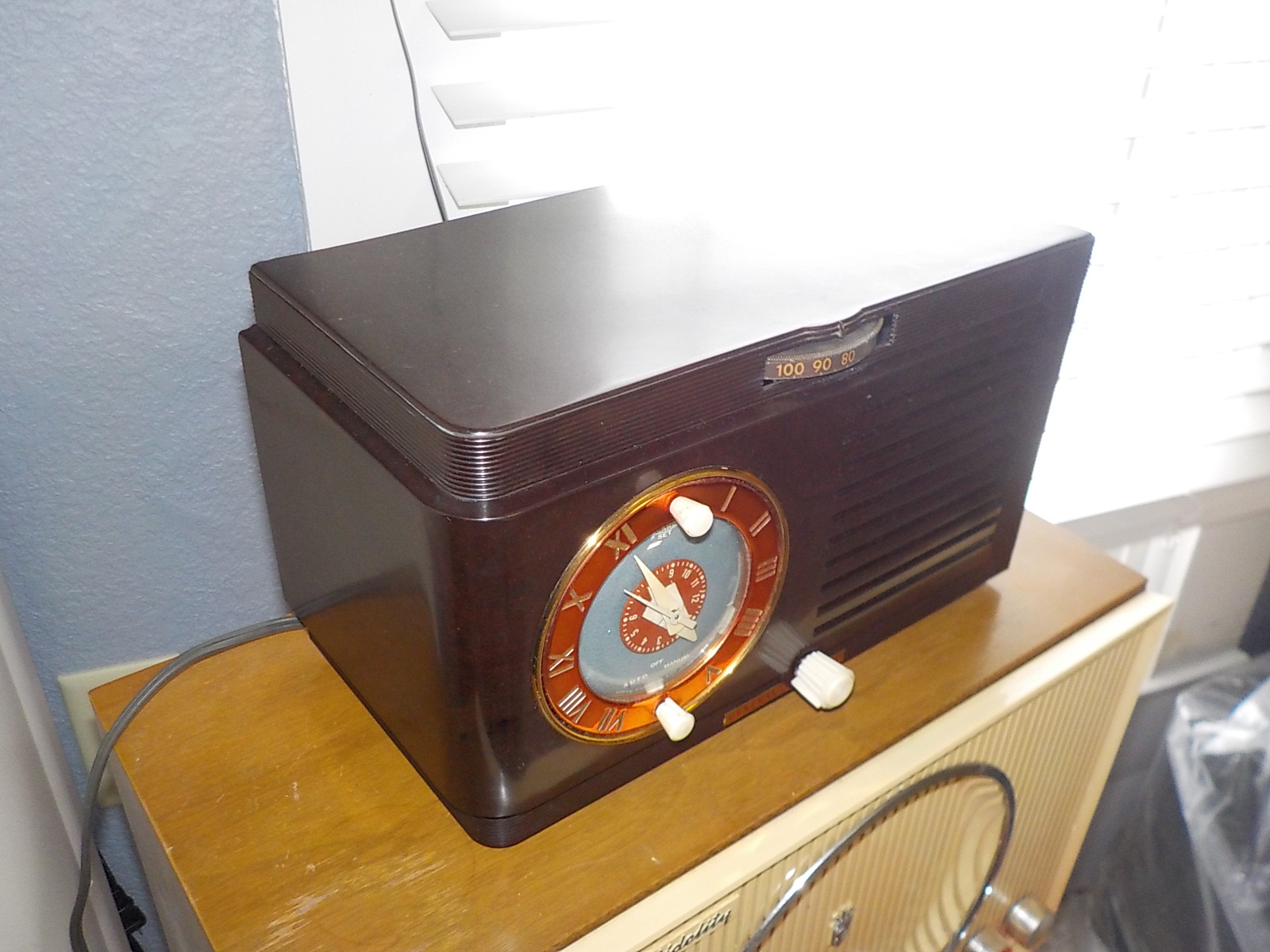

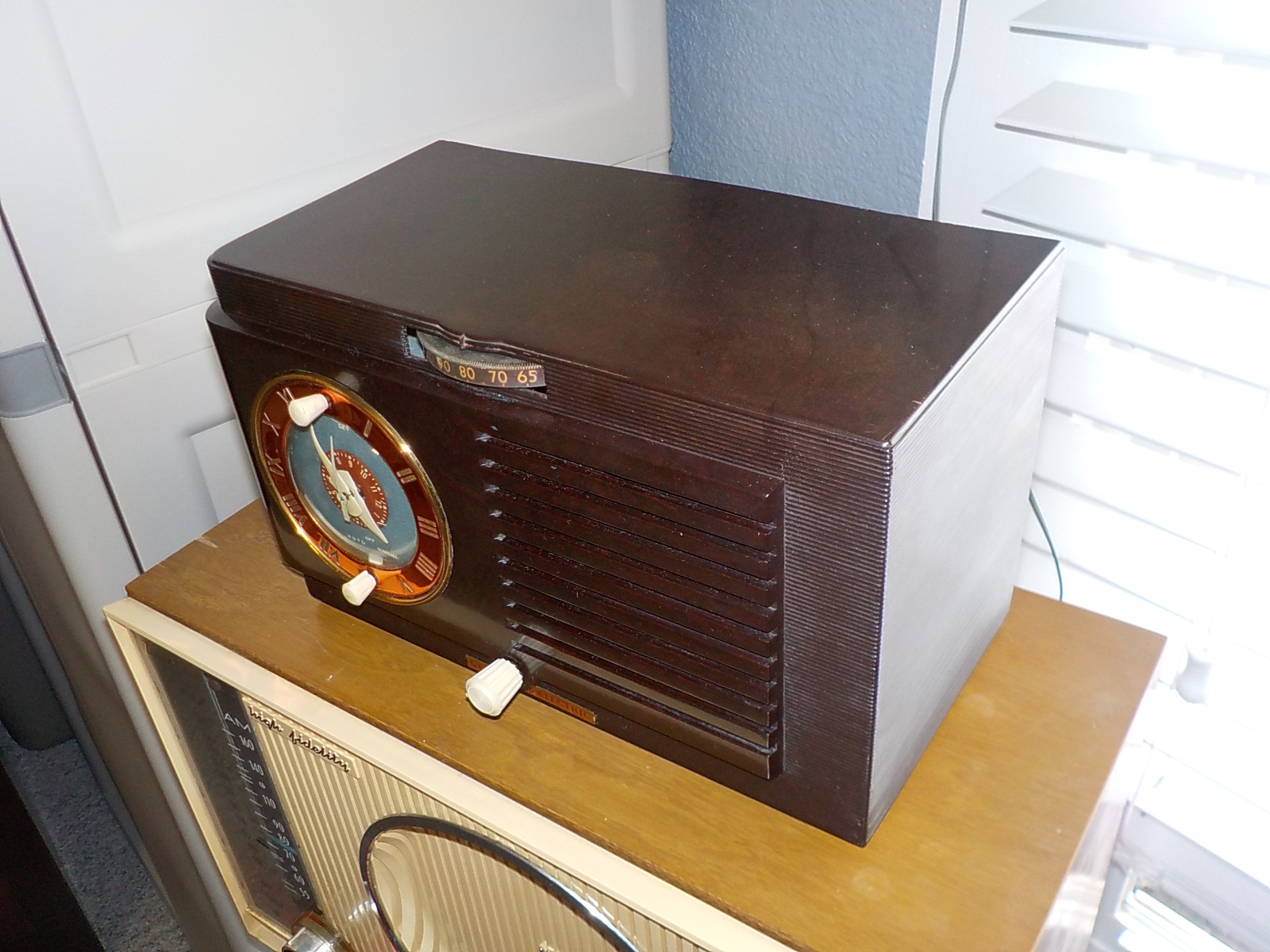

I finally think I have this one up and running. Interesting how something simple isn't always simple. I guess this is part of what makes this hobby interesting. I lubed the clock motor like was posted by Eliot. Thanks, it worked. Still makes some noise, but not as bad. Thanks Henry for sending the back. This was a holdup. After shortening the back by 1/2 inch, and a couple of tries with the connections, it is working great. I have been burning it in for a couple of weeks, and so far so good! I did a little cleaning on the cabinet.
Tim

Good job, that's a nice looking set sitting on top of another nice looking radio
