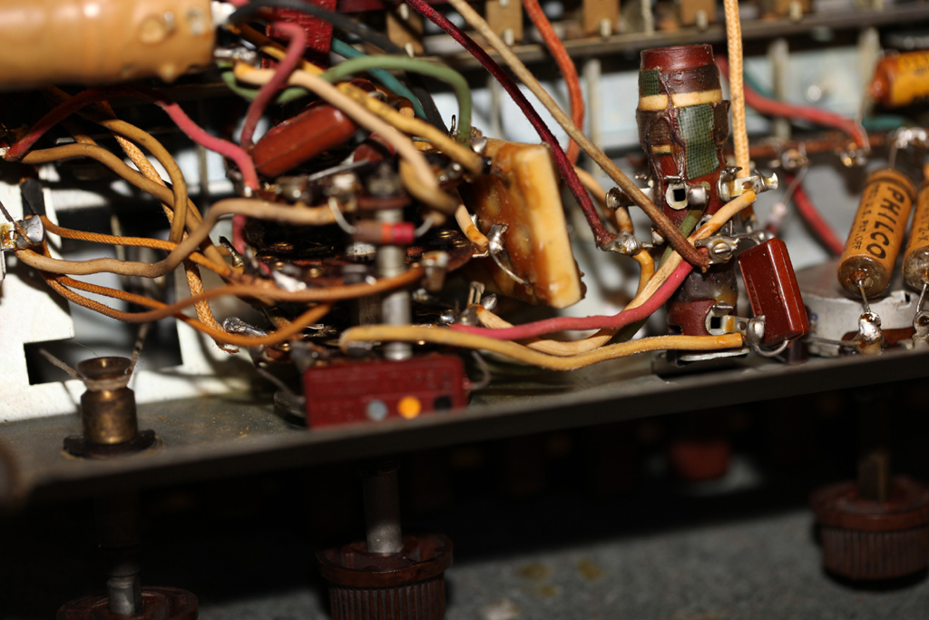

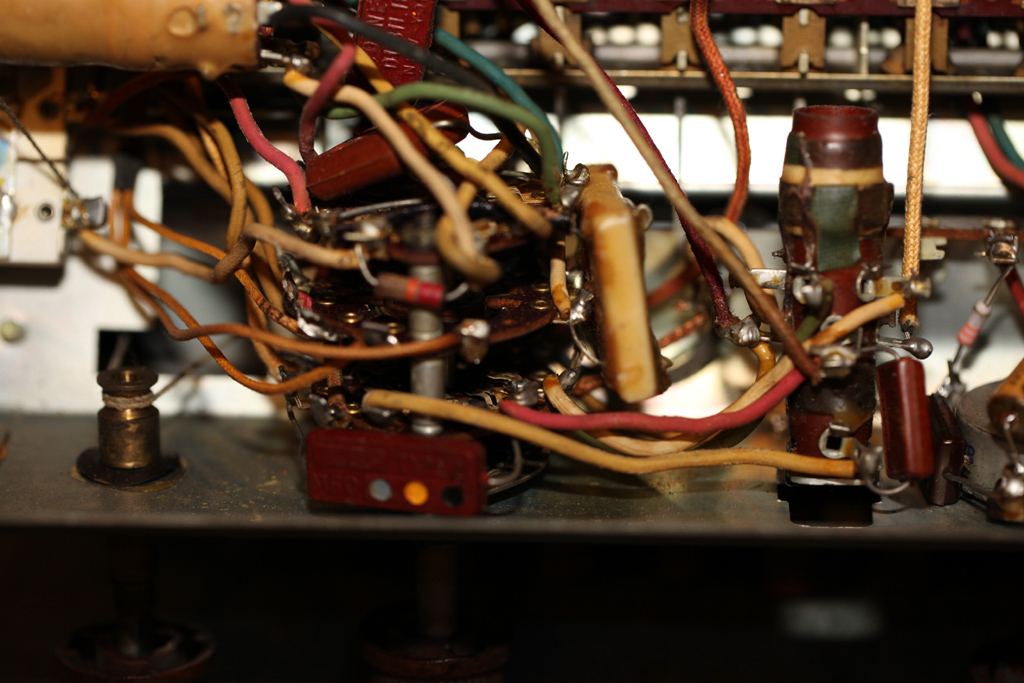

Look at these pictures of the band switch.
You could see on the first a solder lug on the bottom wafer, next to the large white do-hickey that's just bent up and is not soldered to anything. Is it like so in your radio?
And the second bothers me: you could see how on the same wafer, at the same more or less place (I just focuse my macro lens on a different spot) the white wire (to the right of the red) goes to the contact that is raised on a blob of solder and it is above the level where it wipes the sliding contact when it moves by. Though the contact seems to touch that blob. The contact is the third one counting from the stand-off that holds the wafers. What the heck is it and what do you have in its place?

Mike, sorry, I don't have my chassis out. Now, however, I have a reason to. Will look tomorrow. Take care, Gary

Mike, without my schematic or chassis in front of me I'm going with a couple of hunches. The 41-280 does have a gimmick wire in it - that might be your unsoldered wire. Also, if this chassis is like the 41-255 chassis, the white block is a duel mica cap block. At work right now, so can't check to be sure.
Take care, Gary

Gary, no, the gimmick wire is in the tuning cap.

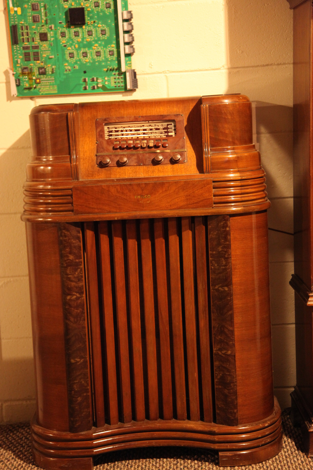

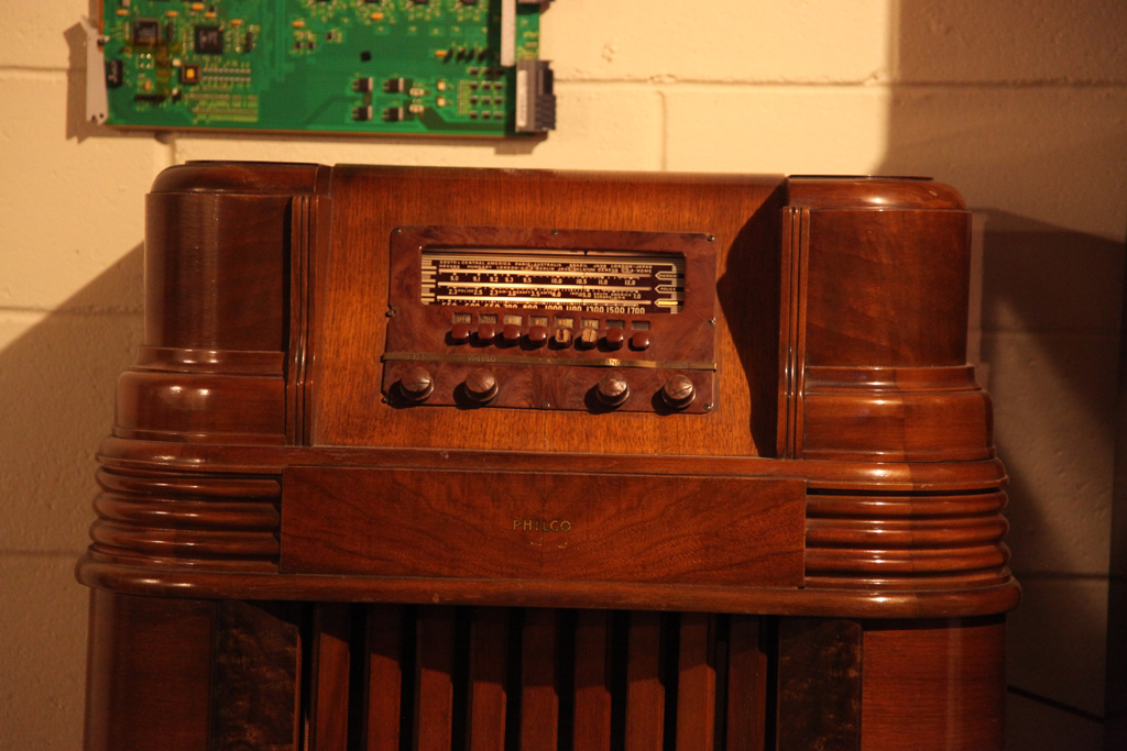

Well, it ain't so bad after all. Not your 37-116 but in the cabinet I could justify keeping it.
I was waiting on the piece of rosin I bought on eBay for 90 cents and free shipping to come, which it did today, so I dissolved it in some pure isopropanol and with a cotton swab soaked the cord a bit in it so it stopped slipping, after which I put it in the cabinet. It is playing as I am writing this.
Some pics.
Playing aglow (could not do it in the dark)
This concludes the restoration.
