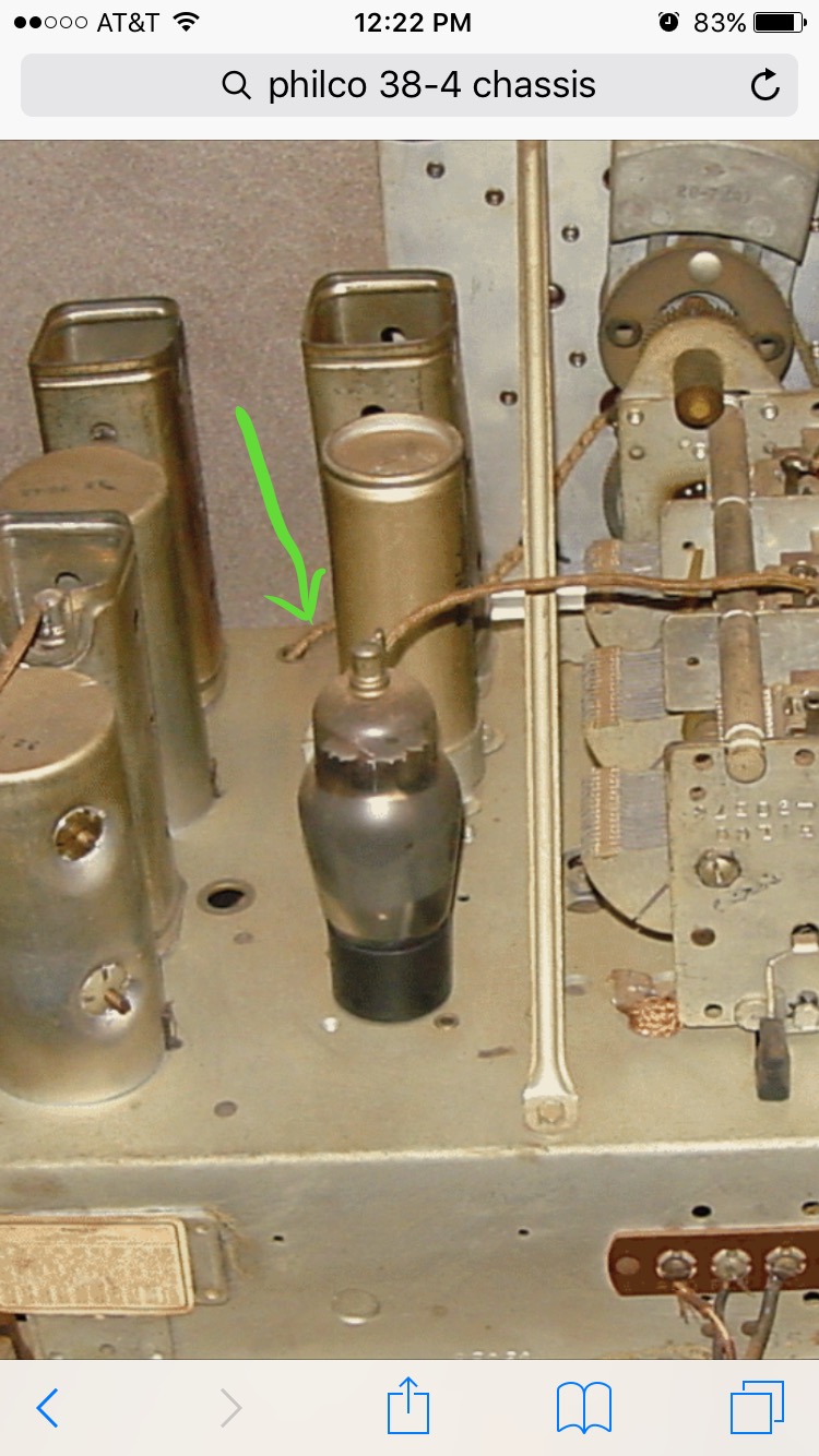

[attachment=14485]Can anyone tell me where this wire attaches under the chassis? I cannot identify it on the diagram. Thanks, Cody ?

Where dose the connected end go?? Best guess is that it for the pilot lamps or the muting switch.
It comes from the back of the dial...its riveted on. It attaches to the round plate directly behind the dial that when the knob is fully depressed, a contact is made from the back of the knob out through the wire in question. Muting switch perhaps? I'm learning!

Yup. It's so when you use the conecentric dial and spinning the dial to get to a desired station you don't hear all the others as you pass by them. It connects down to the volume control wipe (center connection) and is listed on the schematic as #43. Check the resistance to chassis ground to be sure that the switch isn't shorted, that maybe why it's disconnected.
