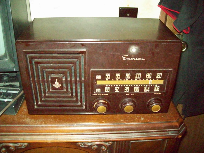

As I mentioned in the January finds post, I ended up getting this fairly nice Emerson 659 yesterday at a decent price (once I found the price tag!). So far, it's shaping up like it's going to be a rather nice radio once I get it recapped. Right now the FM is rather weak and the AM reception is very directional, basically you have to rotate the radio around to get good reception even on our local channel without an external antenna connected. Of course this being a late 40's or early 50's AM-FM radio (some sources say 1949 others 1950-51), it might not ever be strong on FM without an external dipole antenna. As it sits now, it is a working, but a bit tired radio working on a rather old servicing sometime in its past. It does sound fairly good though, having a fairly large speaker inside the case.

  I had an opportunity to buy a Canadian market version of one of these sets, but passed on it because I didn't really care for the styling which is sort of boring, it was an AM only set though. It may be an opportunity to try your hand at restoring one of your own sets, it's fairly simple for an AM/FM unit. There may be one potential snag however, if it has those mini slug tuned IF cans the silver mica caps inside one or both pairs may need replacement, which can be tricky. It also has a selenium rectifier which may be getting weak resulting in low B+ voltage.

I restored one about 3 years ago. They are real nice players and the FM is a great addition. The dial jewel is ALWAYS faded around it. I used some glack shoe polish and then waxed it up. It came out real nice.

I checked and yes, this Emerson has the little IF cans in it. The same type cans my late friend used to describe with not so nice words... Hopefully Emerson used better ones than Zenith.
Just for the heck of it In detached the internal FM antenna and just clipped one of my jumper wires to the screw. Yes Virginia, the Emerson does actually work on FM. Seems the internal antenna is either not good or the way I have the cord routed is not good for reception. Still not super loud, but that's good as the Emerson has bass on FM, too much! Even with the tone control turned all the way to treble this radio can still develop the dreaded cabinet rattle. Still it's encouraging to now get FM stations clear across the dial.

  If you take a look at the parts list there is very little in the way of capacitors to replace, most of the set seems to use ceramic caps, of course that still leaves the electrolytics and carbon comp resistors to deal with. The selenium rectifier is probably tired, I would bet if you checked the B+ voltages with your volt meter you will find that it's probably down at least 20% or more, be careful if you do though, this is a true hot chassis set.
The Emerson is back in operation! Seven wax capacitors, new filters, and replacing the aging selenium rectifier has done wonders for this radio. Actually picks up stations a lot better, especially FM where I have it sitting right now. Still a little directional on the AM antenna as it seems to prefer sitting with the back pointing SE while I currently have it sitting with the antenna back facing West-ward. Of course, that is also facing the hillside right behind the house. Still, this is a nice little AM-FM radio with rather good sound. The shop owner, and friend of mine, told me this one has the little neon bulb in it, which puts it as the first version of this radio for Emerson if what I have researched is correct.
