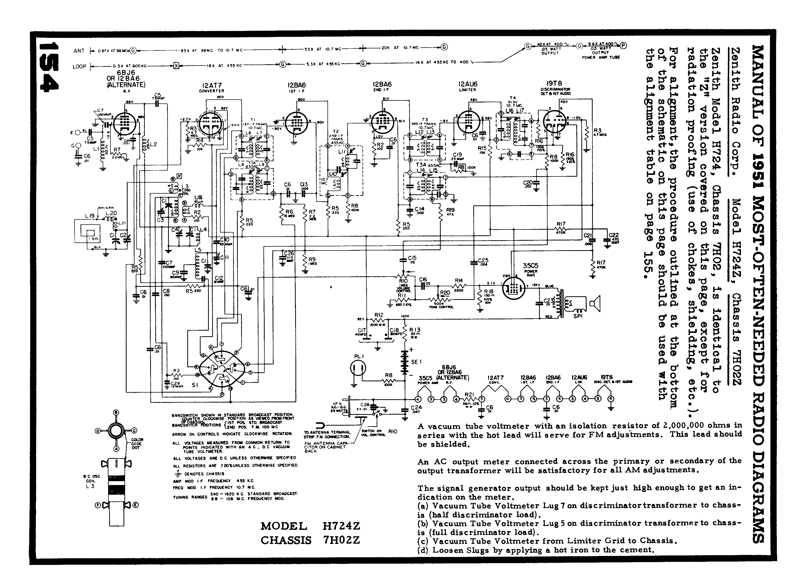

Sorry I can not answer your question, but living in the country 30 miles to FM station I notice some drift over time without AFC. Here is one I restored a few years back. Have several Z sets very much alike some with AFC some without.

Generally speaking it wasn't till the mid 50's that afc was incorporated. If you are looking for good performance stay away from the late 40's/early 50's fm sets.

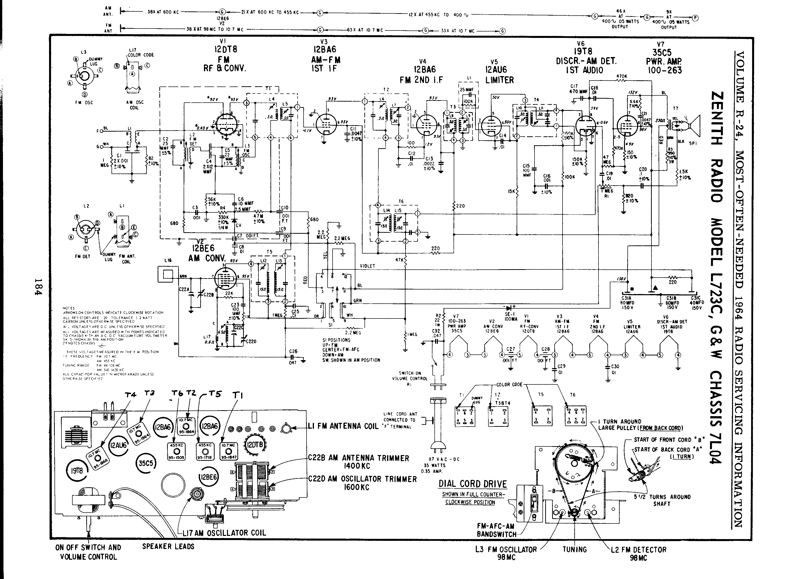

If one would like to compare the different circuits this has AFC. this set is one my Late father in law owned which I was able to restore.

Thanks for taking the trouble with the Diagrams, I have several later model AM/FM Z's and they are good players even some cheaper ones from just before they stopped making them.
