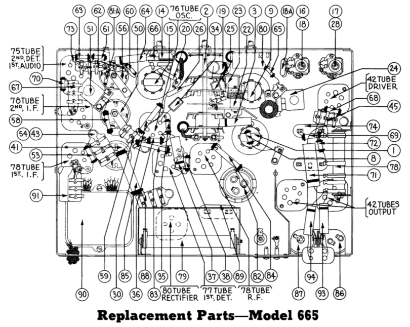

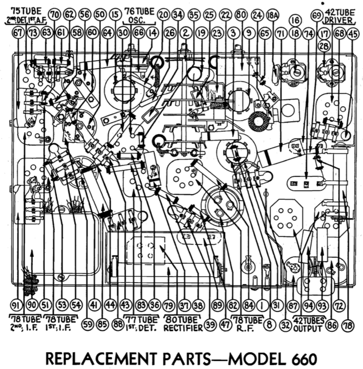

Comparing the 660 to 665 under-chassis pictures to your photo:
You've got a 660.
-> Part #32 is present on your chassis, not on 665
-> Part #39 is present on your chassis, not on 665
-> Part #71 is present on your chassis, not on 665
P.S. it turns out that the 660 and 665 use the same transformer and dial scale parts.

Well this clinches it then. Thank you for the in depth research Nathan.
