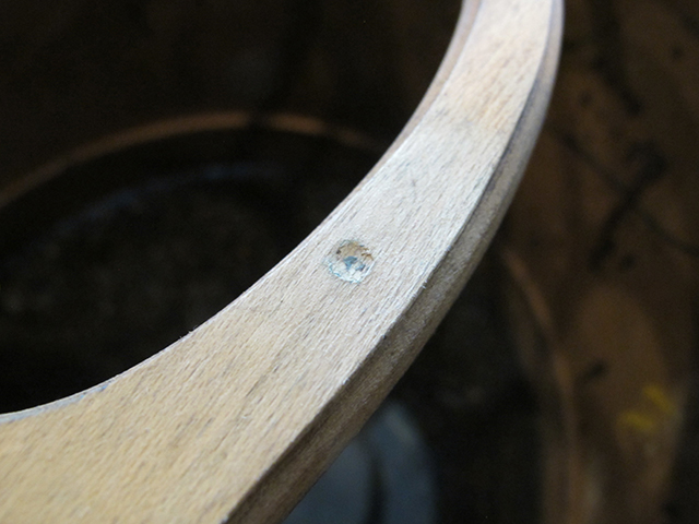

Problem; on the front, there is what looks like a small round indentation that looks like what you would see if the radio had been shot with a BB gun.
What is the best way to fill this?

Don't fill.
Use an iron to steam the dent out. Caution: this may loosen veneer.

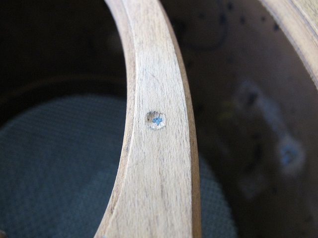

Ok, just tried hot iron with a damp wash cloth, it did raise the indentation, should I try some more? I'm afraid of raising the veneer.
Looks like a piece of the blue washcloth is in the indentation.
Lewis
If it is cloth then it should be able to be picked out of there with a needle or if you have it, a dental tool. Gently scrape it to see if you can loosen it up and get it out. I don't have any experience with steaming out dents so listen to what Russ (phlogiston) says.

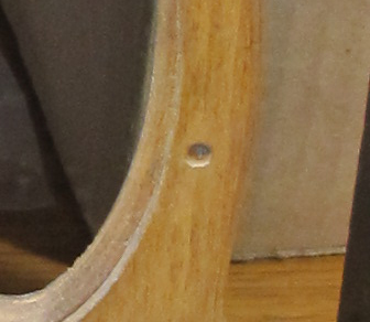

        Tried some more steam, does not seem to want to rise up any more.
Here's a pic of the original indentation and with the latest round of steam.
I read on the net about radio cabinet restoration using glue and sawdust. Is this something worth trying at this point?
Lewis
It looks like some of the wood has been lost. So more steam probably won't help. Use mahogany wood filler - or walnut or a mix of both. Mahogany is usually too light and walnut too dark. TOO DARK usually looks better than too light.
