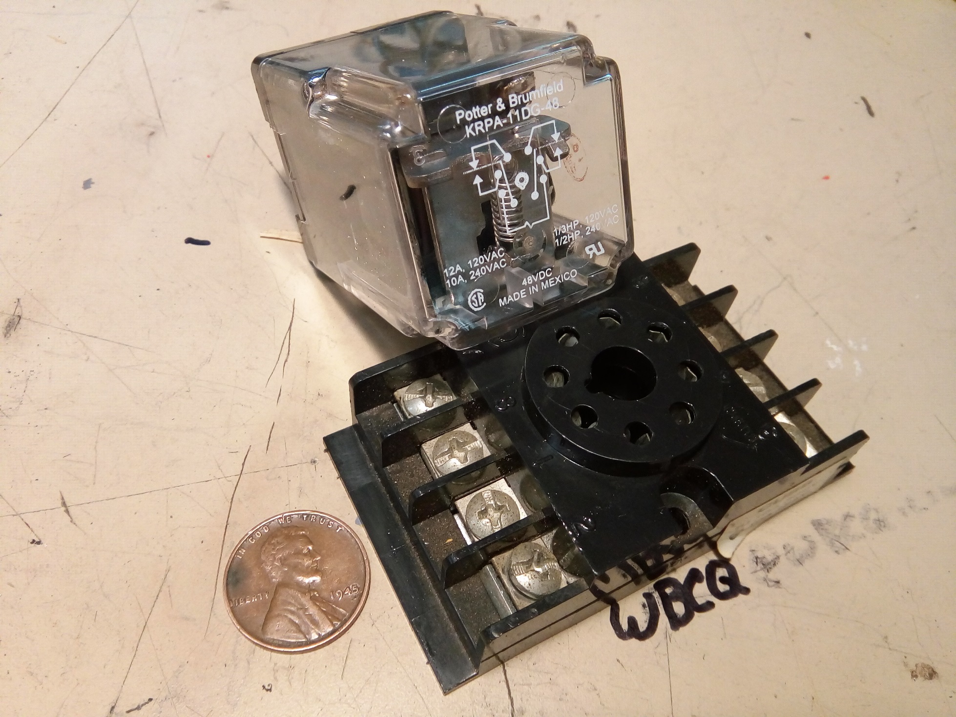

sometimes i tend to think about things i already know to make repairs on things that are broke.
since i dont know enough about old radios,, but enough to hold my own, i think about things i see that will work to fix something else.
here is an example you all may find useful where tube sockets are still being made for a totally different application.
the base that the ice cube relay plugs into is usually a couple bucks.
 just trying to share what i find.
ignore the application of the relay itself,, its a -48v 10kamp dc plant shunt mux power source relay from the fero days of rectifiers.
Yeppers, those sockets are great for prototyping. Some are made for DIN rail, others can be mounted below a chassis, flip the screw terminals.

Fortunately the more traditional octal sockets are not at all difficult to find either, also thanks to relays, the Japanese Omron company also makes them, theirs look much like an Amphenol made octal mounted to a diamond shaped mounting plate. I've used some Soviet/Russian Amphenol copies,(actually improved copies), for socket replacement, they were intended to install into a keyed hole in a chassis so I had to cement them in place to stop them from moving in a chassis with non keyed socket holes.
