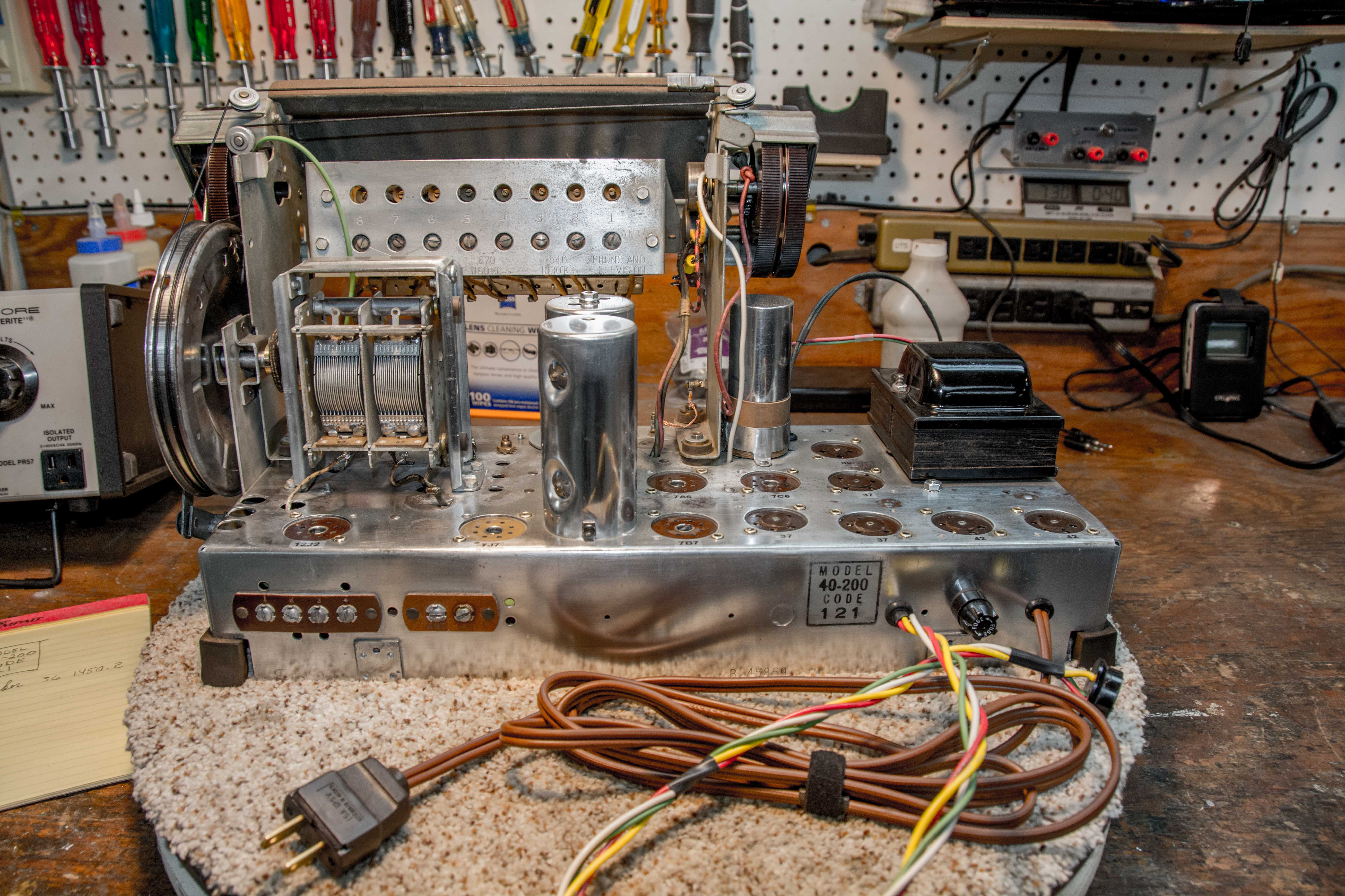

I've just finished restoring a Philco 40-200 and did the alignment and is working great.
Now I'm trying to adjust the push buttons and buttons 1-4 won't adjust below 1200 KHz.
The upper buttons (5-8) work well, I adjusted them 1050-1400 KHz.

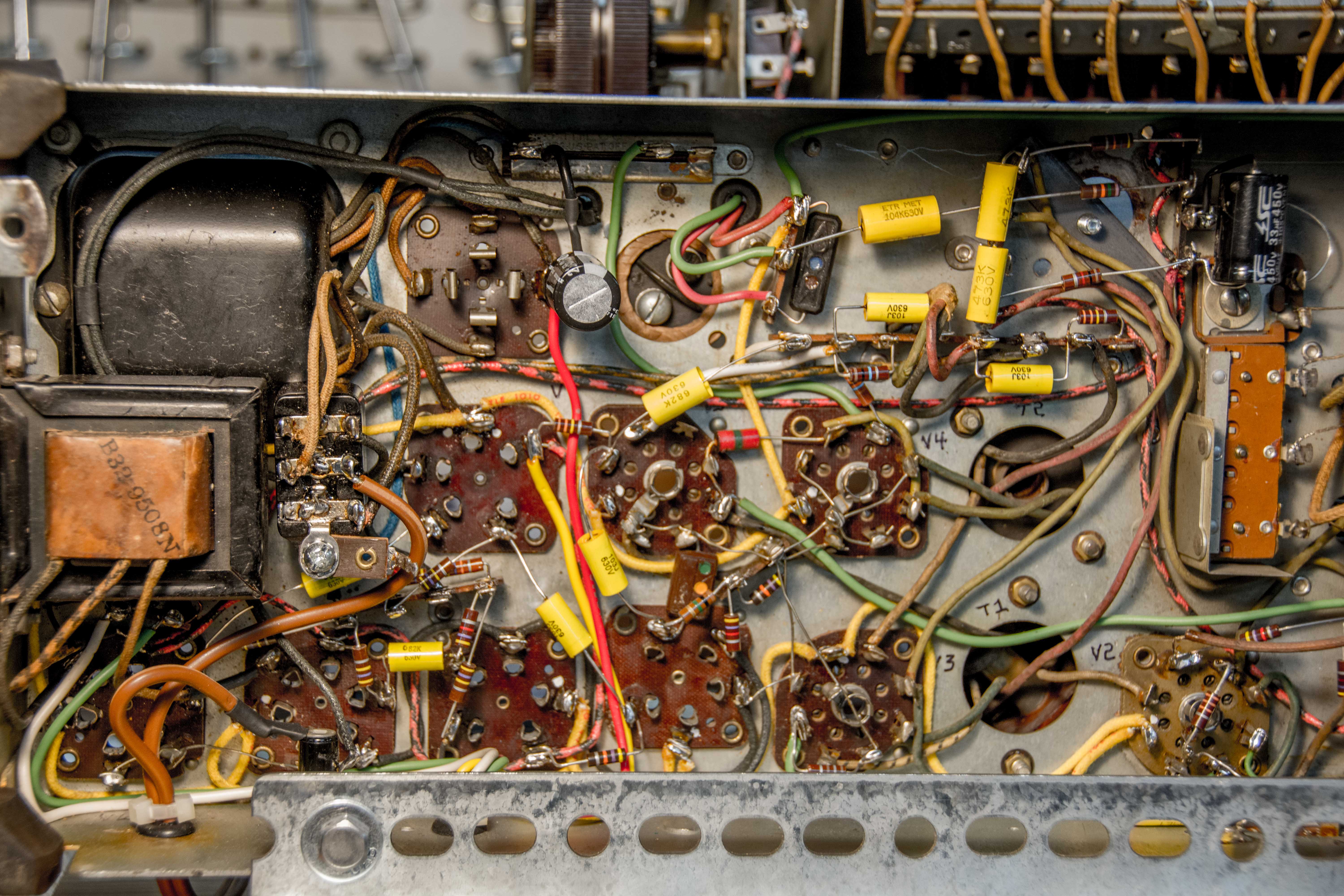

is this a safe plugin to download in order to get the document you posted Terry?
>>>>>>>>LizardTech DjVu browser plug-in
also,,, never seen a skinny domino cap like the one top center of your underside of the chassis!
