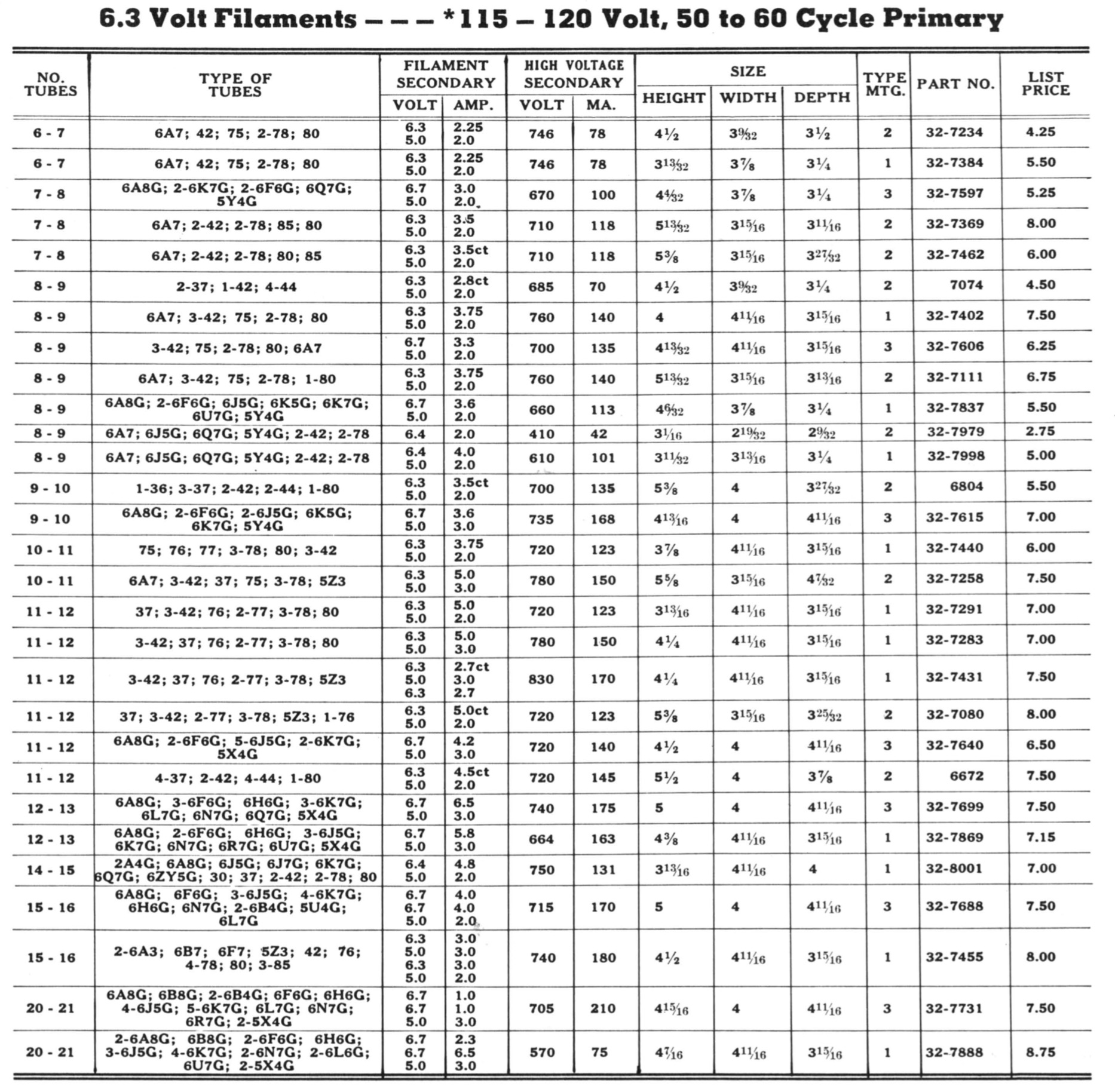

Actually the 1939 Philco Parts Catalog has the specs for the 32-8001 transformer in the 39-116:
That transformer was also used in:
  • 40-516
  • 40-216
Unfortunately I couldn't find the specs for the 32-7999.
